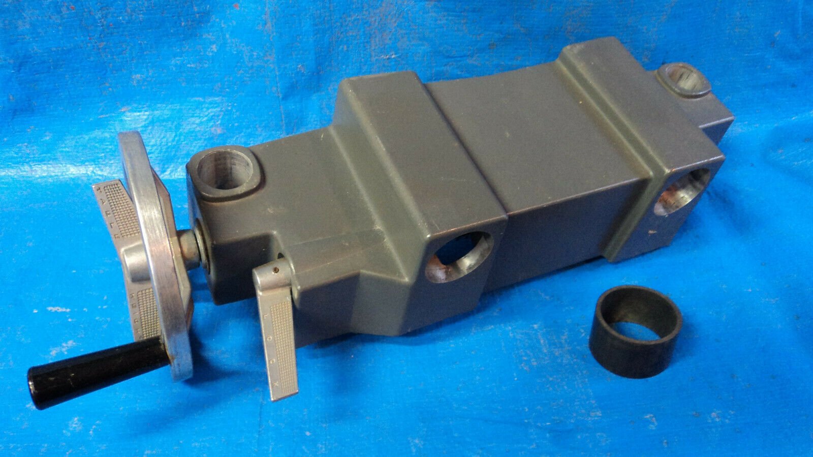

Re: SS 5990B Planer with autofeed - coversion to manual
The Handle and Screw are in the plastic bag. I believe, but have not confirmed, that they are the same parts used on the Carriage of the 510/520/M7 to raise and lower the Main Table.
_
510 carriage early.jpg (207.53 KiB) Viewed 148 times

Posts: 4526
Jim,
br549's experience adding a Manual Feed to his Mark Mount Planer may be more helpful than what you have received so far. Do keep in mind that his making a Manual Feed was over 10 years ago and new OEM parts from Shopsmith are more limited for the Planers than before. Used parts still come up for sale so keep an eye out for them.
As for the Crank Handle it is the same part number as the one for the Carriage as mentioned in my previous post.
