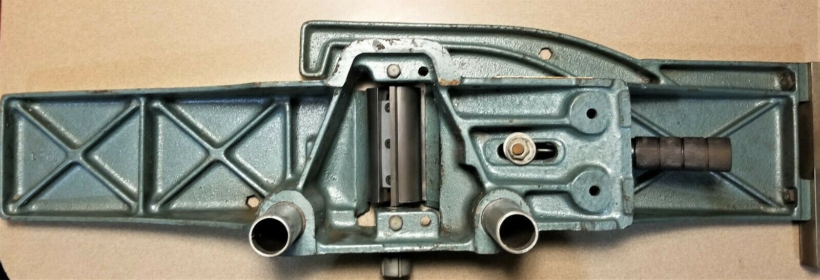

The picture below shows a 1950's Greenie Jointer for reference as to which holes are for what. You can see the Cutter Head mounted in the proper holes. If you did drill out those holes for some reason it may be more difficult to mount the Bearing Housings correctly to align the Cutterhead. Those mounting holes are not threaded. The other pair of holes are for mounting the Dust Chute. On older Jointers like the Greenie shown those holes are not threaded. Later Jointers have those holes threaded and the threaded hole itself is smaller. If you had used larger bolts to hold the old Bearing Housings for the Cutterhead you could use those in place of the new bolts and Bearing Housings if they are still useable.
_
13521 bottom.jpg (198.7 KiB) Viewed 24 times

I found some stainless steel spacers on Amazon that will adapt the holes I drilled out to exactly the right size for the original bolts (which I found squirreled away in my bin for Shopsmith bits and bobs). Yay!
