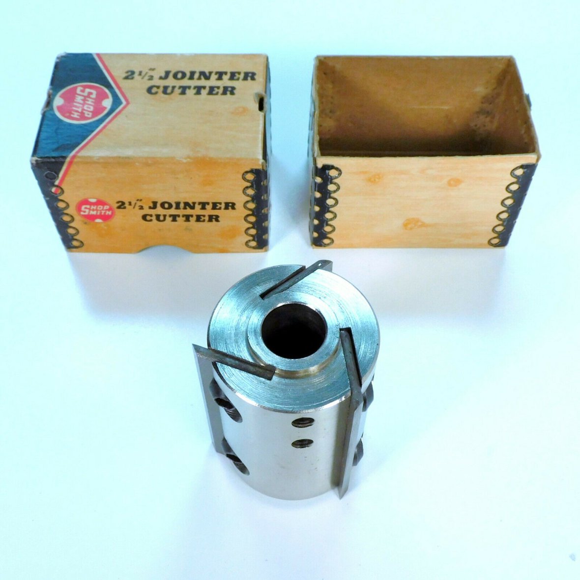

Another accessory which was a carryover from the Model 10's was the Magna 2-1/2" Jointer Cutterhead part number 12 230. It was to be used with the Shaper Fence. This was another accessory that the set screw size changed with the introduction of the Mark 5. It would come as shown below but for the Mark 5 era it would have the 5/16" set screws to attach it to the Quill's Spindle. The earlier Model 10 version had 1/4" set screws

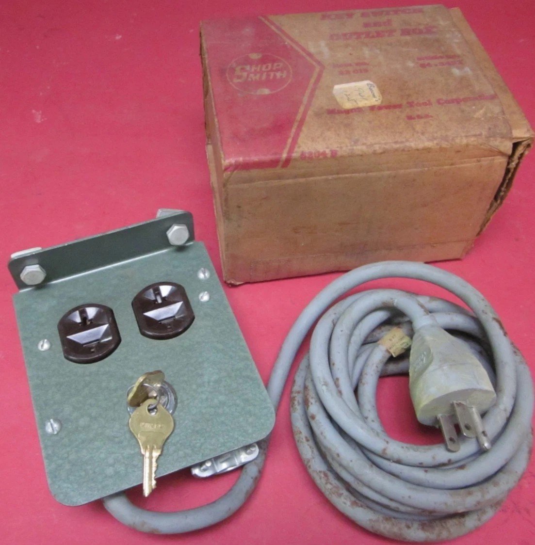

An interesting accessory was the Key Switch and Outlet Box part number 22 015. It is shown below with the box it came in. I am not sure when it first came out but is in the February 1955 catalog. This was a safety item allowing the Mark 5 power to be locked out when not in use. It mounted on the bottom of the Lock Bar through the extra holes that holds the Bench Tubes to the Bench Ends. For use it required cutting off the power cord plug from the headstock and wiring it to the switch.

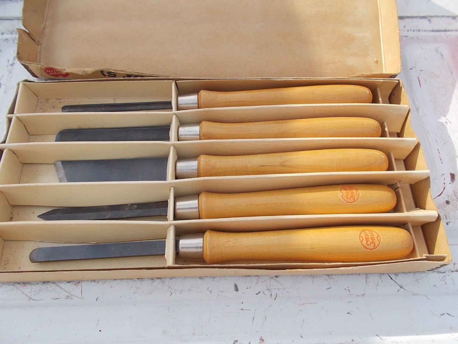

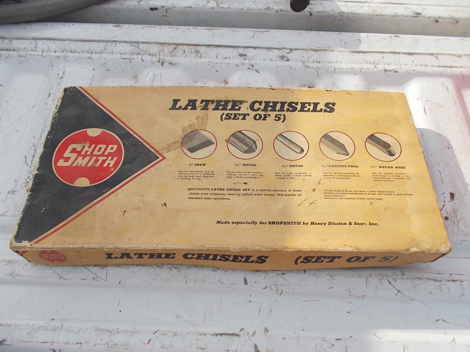

Lathe Chisels part number 12 301 were an accessory item that did not come with the purchase of a Mark 5. For 1954 they would be the second version of the Lathe Chisels with a red logo stamped into the handle in a box from Magna Engineering Corporation. This version predates the introduction of the Mark 5 but carried over to it.
