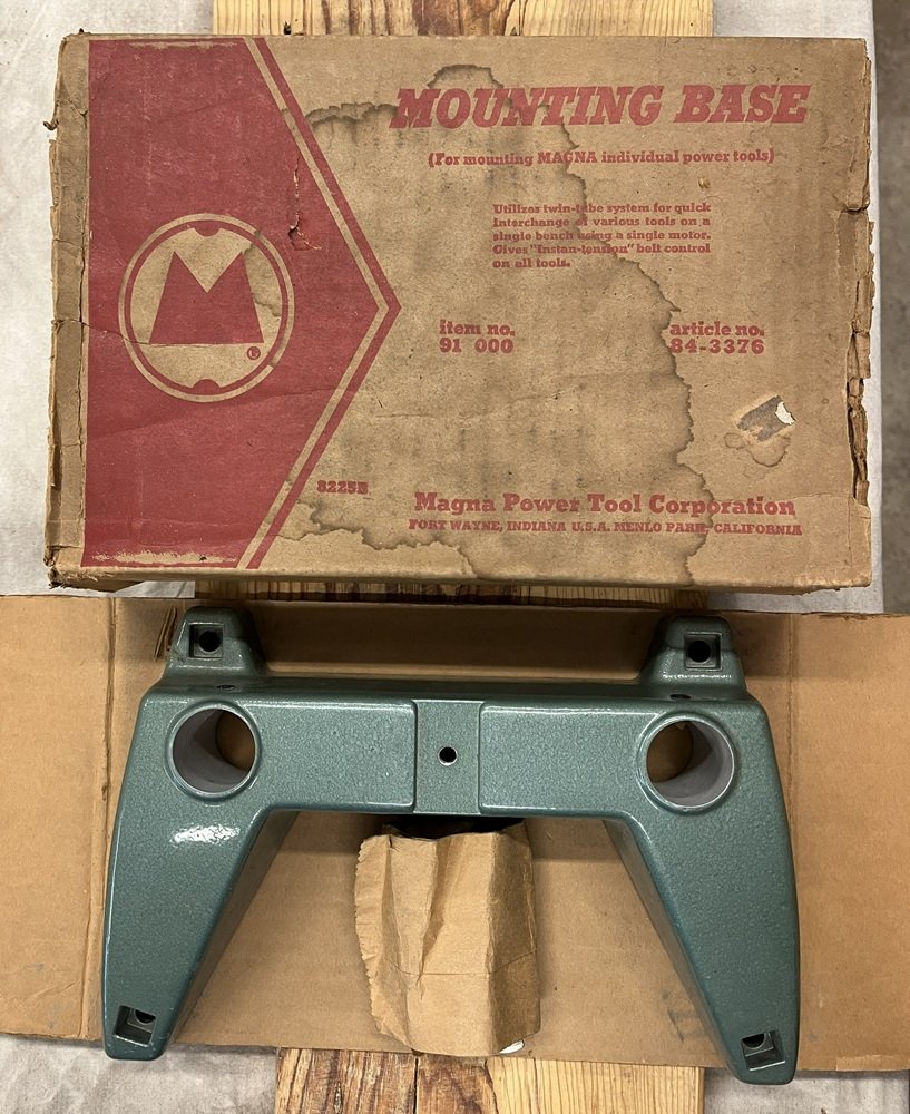

Rest oleum has reduced the number of color options for the Hammered Finnish Paint. There was an Antique Silver that I have used which was a bit grayish then a bright silver. Age is a factor in how the original colors look today. The Mark 5 shown in the picture I previously posted had a lot of poor condition paint. The Headstock casting itself had almost no paint left on it. I do have a really good example of the Green Hammered Finnish paint from a Mounting Base from the 1950's still new in box. The mounting hardware is still in the little brown bag.
_
91 000 Mounting Base.jpg (191 KiB) Viewed 43 times
Yet another thing to watch for to add to your collection.

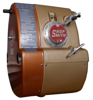

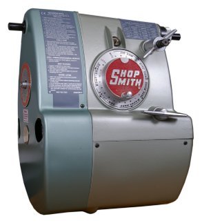

In the past Shopsmith sold touch up paint in spray cans for not only the gray but the gold and copper of the Mark 5 Goldies and two green colors both a dark and a light green. None of them were a Hammered Finnish. Below are the pictures Shopsmith had in the online catalog for the Greenie and Goldie Touch Up Paint examples.
