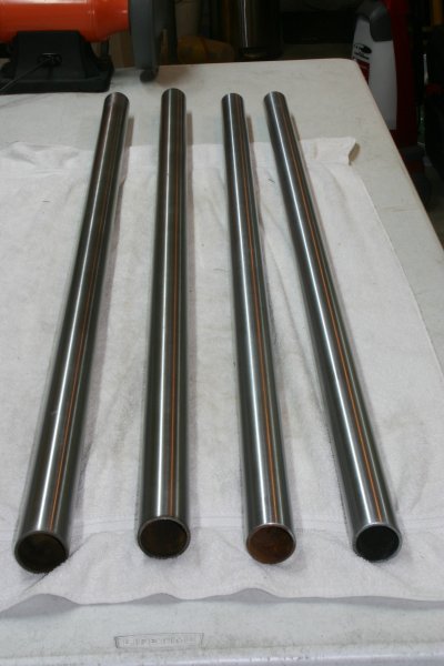

Also completed the bench and way tubes. Bench tubes went through the electrolysis baththen both bench and way tubes were sanded on the drill setupdiscussed in another thread. Polished them up with Johnson's Original Paste wax and they look good as new.
[ATTACH]3564[/ATTACH][ATTACH]3563[/ATTACH]

Micky - I'm curious about the drill setup you used, but searched the post and couldn't find details. Got a set of tubes that aren't rusted to the point of needing electrolysis, but would certainly benefit from a good polishing.mickyd wrote:Also complete the bench and way tubes. Bench tubes went through the electrolysis bath then both bench and way tubes were sanded on the drill setup discussed previously in the thread. Polished them up with Johnson's Original Paste wax and they look good as new.

Matt,thainglo wrote:Micky - I'm curious about the drill setup you used, but searched the post and couldn't find details. Got a set of tubes that aren't rusted to the point of needing electrolysis, but would certainly benefit from a good polishing.
Thanks!
Matt
The drill setup I used was buried in a thread "Crocus Cloth Substitute". Here's the link to the info. It's post #14.
http://www.shopsmith.net/forums/showthr ... BENCH+TUBE
Note: Expansion plug sizes below were updated 3/26/09 to correct errors.
It's a pretty straight forward process. You'll need a 1-1/2" to 1-3/4" expansion plug to do your bench tubes and a 1-1/4" to 1-3/8" to do your way tubes. In my setup, the far end of the tubes weren't chucked but next time, I think I would use an expansion tube on that side also. The far end just spun resting again a stop and they actually got pretty hot on that side. Even resting that side on a towel to reduce friction wasn't enough to keep them cool.

p.s. If you take your time and make sure the expansion plugs go in nice and straight and you keep the drill RPM reasonable, they'll run true enough where it's not a safety hazard. I had my wife supervise when I did the way tubes because I couldn't get it to run as true as the bench tube. She watched the setup to make sure it wasn't moving. I think it didn't run as true as the bench tubes because of the amount the expansion the plug had expand to fit tightly. It just didn't expand accurately. The 1-1/2"' plug for the bench tubes fit much closer right out out of the shoot.

Great info Mike! Saw your other post first with the picture showing a very simple, useful setup. I'll try that out this weekend, assuming I can find some expansion plugs. Did you pick those up at the local hardware store?
