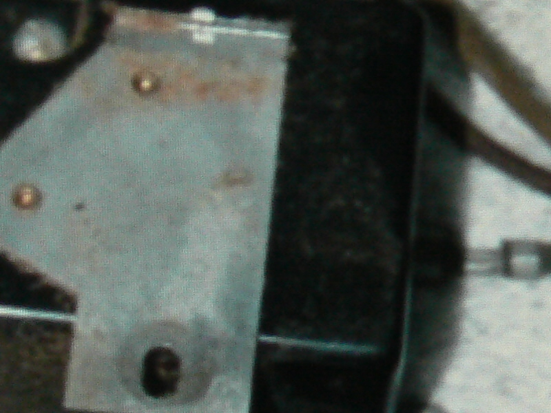

NO!mickyd wrote:This one??
[ATTACH]3585[/ATTACH]
If yes, yes. If no, ?????:eek:
Upper left on the RELAY Mike.
- mickyd
- Posts: 2999
- Location: San Diego, CA
JPG40504 wrote:NO!
The only cover over the relay (also goes over the capacitor) is a paper cover that goes between a holding bracket (not shown in the pic) and the relay / capacitor. The holding bracket screws into the raised boss in the approximate center of the back starter cover with a ~2" ~#8 hex slot machine screw.
Acceptable answer now grasshopper?? If not, we'll have to define x-y coordinates for the photo to narrow down where your "upper left' is.

Your upper left refers to the entire picture, my upper left was referring to the relay. Is this 'upper left' now?mickyd wrote:We must see "upper left" differently.
My upper left is truly upper left. Your upper left is somewhere else:D
[ATTACH]3588[/ATTACH]
Sorry about focus, best I could taking pix of your pix off lcd screen.
This screw was put there for a reason. I assume it is to hold the RELAY COVER on(not cover it up/insulate it). Try taking the screw loose and see if the relay innards are suddenly accessable. Look for whatever returns the movable contacts back to OPEN position. My thinking is to try and increase the spring tension so as to MAYBE solve the 'clicking' described elsewhere.

I'll be installing the new relay I picked up tonight. If it works I'm going to attempt to take the old relay apart. I'll let you know.JPG40504 wrote:Your upper left refers to the entire picture, my upper left was referring to the relay. Is this 'upper left' now?
This screw was put there for a reason. I assume it is to hold the RELAY COVER on(not cover it up/insulate it). Try taking the screw loose and see if the relay innards are suddenly accessable. Look for whatever returns the movable contacts back to closed position. My thinking is to try and increase the spring tension so as to MAYBE solve the 'clicking' described elsewhere.

bucksaw wrote:I'll be installing the new relay I picked up tonight. If it works I'm going to attempt to take the old relay apart. I'll let you know.
Installed the new relay. Same size and mount. Worked just fine.

The screw on the relay allows you to remove the cover on the relay. Just removing the cover will not break anything.JPG40504 wrote:Your upper left refers to the entire picture, my upper left was referring to the relay. Is this 'upper left' now?
BTW see post #119!
P.S. changed 'closed' to 'OPEN'.

Changing the way it functions IS the point. Now that you have determined a 'new' replacement IS available, the risk is acceptable. However why bother if a new one WILL fix it!:)bucksaw wrote:The screw on the relay allows you to remove the cover on the relay. Just removing the cover will not brake anything. If you mess with the point adjustments inside you might ruin the relay.
