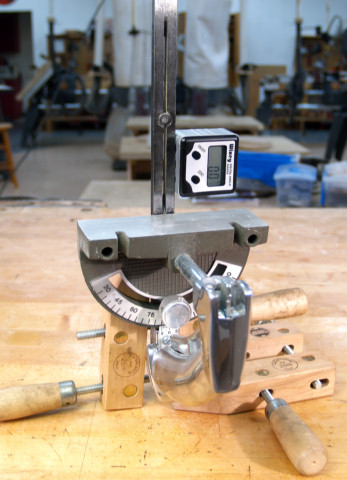

Clamp the bar of your miter gauge so its roughly vertical -- the actual angle to the horizon doesn't matter. Attach the angle gauge to the bar magnetically and "zero" it.

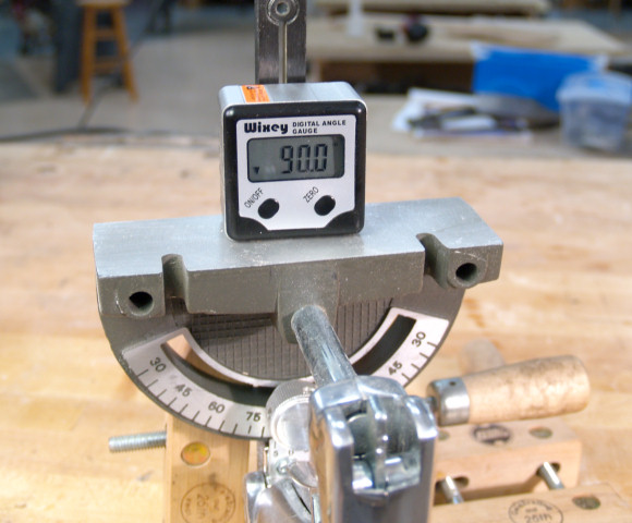

Remove the gauge from the bar and rest it on the face of the miter gauge. Adjust the face until the gauge reads "90.0." Cool, huh?

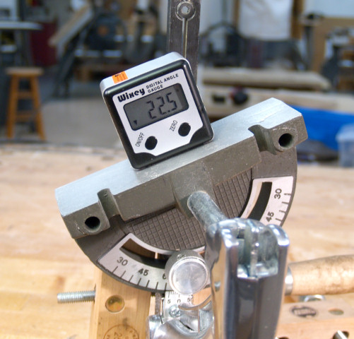

And you can take it a step further. Let's say your real goal was to cut 22-1/2 degree miters to make an octagonal frame. With the miter gauge face now precisely square to the bar, "zero" the angle gauge again. Then tilt the miter gauge face until the angle gauge reads "22.5." Cooler and cooler.

Nick wrote: Remove the gauge from the bar and rest it on the face of the miter gauge. Adjust the face until the gauge reads "90.0." Cool, huh?
Was I wrong to think most of the Shopsmith parts are not magnetic? What are you attaching to? I thought about getting the Wixey products but when I inquired they said they did not work with the Shopsmith.
Guess I may have to check again.

I suspect he is using gravity in the second picture (where the Wixey is reading 90 degrees). I use it to make sure the blade is 90 degrees to the table - the blade is steel so I zero it on the blade then use gravity to set the Wixey on the table and adjust it to 90 degrees.

No, you are correct when you say most of the Shopsmith is not magnetic, at least not the parts that you are most likely going to want to attach the Wixey to but that is not a problem.
