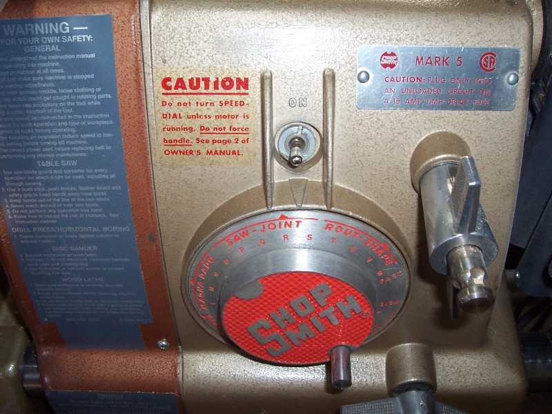

Here is a picture of the labels on my Mark V (1962 model as far as I can tell).
[ATTACH]3776[/ATTACH]
With all of the discussions about original factory caution labels, now I am wondering when and how many machines had the metal riveted caution plate to the right of the toggle switch. Note: The two grey stick on labels on the belt guard were added just because that is what I got when I ordered labels not knowing what I was getting.
Also, does anyone know what the symbol "SA or CSA" to the right of the word "Mark V" is referring to?? Thanks, John McCrossen

Judasprey1982; Yes, the paint on this one is original and in pretty good shape. Only a few minor scratches and dings. It is still too nice to repaint. John

Looks like mine(except the paint is in MUCH better condition than mine). The CSA is the canadian equivalent to UL.
