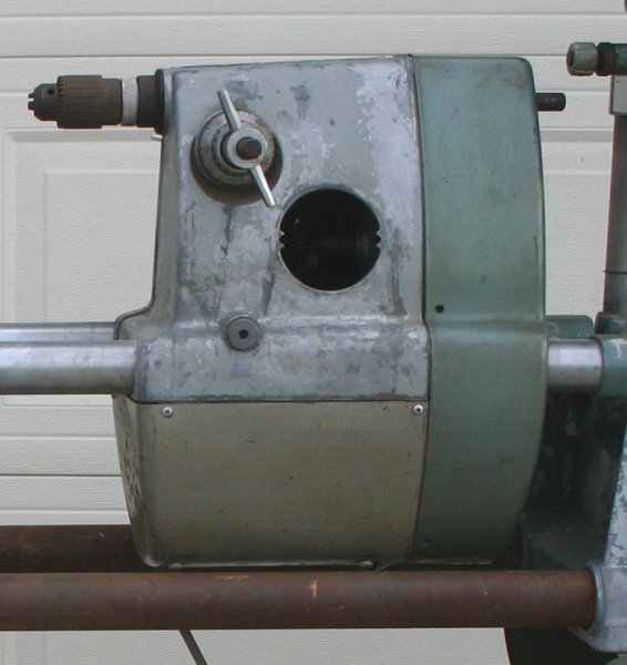

On my old '55 Greenie's, how is the ShopSmith logo cover that goes over the access hole in the headstock supposed to held in place? The exploded view in the parts list doesn't show anything.
mickyd wrote:How is the ShopSmith logo cover that goes over the access hole in the headstock held in place?
Mine is "pinned" at the top with a screw on the bottom. Remove the screw, pivot the cover up on the pin. I understand that older units have a spring clip holding it in place, but I have knot seen it myself. The "really old" ones did knot have an access hole behind the logo, but it is adviseable to cut one out there.
Tim
mickyd wrote:On my old '55 Greenie's, how is the ShopSmith logo cover that goes over the access hole in the headstock supposed to held in place? The exploded view in the parts list doesn't show anything.
How was it held in place when you took it off??? or did you add the access hole, and now want to 'plug it'? The Goldie vintage have a VERY STIFF spring attached to the back of the 'medallion' and two posts which slip into two notches at opposite sides of the access hole(they do a real good job of scratching the top of your hands when you try to stick them through the hole).
Later models did away with the spring and posts as Tim has described.
If you added the hole, you are dependent on your powers of creativity!:D
P.S. Did you take any B4 pix of the back side?
JPG40504 wrote:How was it held in place when you took it off??? or did you add the access hole, and now want to 'plug it'? The Goldie vintage have a VERY STIFF spring attached to the back of the 'medallion' and two posts which slip into two notches at opposite sides of the access hole(they do a real good job of scratching the top of your hands when you try to stick them through the hole).
It was in a box when I brought her home. No attaching hardware with it. Headstock already had the access hole. I don't have a photo right now of the logo cover but it has two pins that fit into the ears shown in the headstock photo.
mickyd wrote:It was in a box when I brought her home. No attaching hardware with it. Headstock already had the access hole. I don't have a photo right now of the logo cover but it has two pins that fit into the ears shown in the headstock photo.
[ATTACH]4294[/ATTACH]
It is supposed to also have that cursed stiff spring attached to the medallion/logo. I will try to post a pix.
[ATTACH]4295[/ATTACH]
BTW the saw blade is what happens when you leave a saw blade in evaporust and air too long. It seems to have acquired a nice black oxide finish??????
JPG40504 wrote:It is supposed to also have that cursed stiff spring attached to the medallion/logo. I will try to post a pix................
Is that spring steel on the back of the cover? Looks quite thick. Also, is it symetrical to the centerline of the cover. Note sure due to the angle the photo was taken at. Do you need to use a screwdriver to put it on by flexing the lower end of it after inserting the upper end into the headstock?
