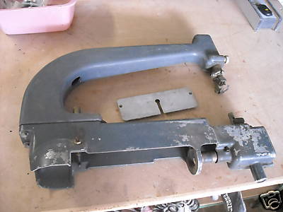

Do any of you know by looking at this picture if it would fit a Mark V?
[ATTACH]4613[/ATTACH]
which machine with this jigsaw fit?
- jig saw.jpg (17.02 KiB) Viewed 3294 times
Looks like a 10E or ER. Check this out http://lumberjocks.com/reviews/248

Since it is designed to attach directly on to the headstock of the 10 e/r, the answer is 'NO, it will NOT fit a Mark 5/V.baddlad wrote:Do any of you know by looking at this picture if it would fit a Mark V?
