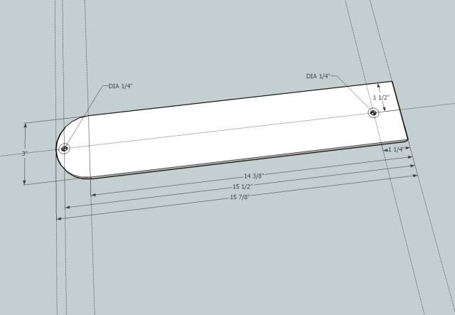

Lower that table down on the revolving blade very slowly. I have had hard board break near the screw holes and I have decided it was because I was lower onto the blade too aggressively.
I just made a dozen blanks and cut three of them with no problem.[ATTACH]4637[/ATTACH]

dusty wrote:Lower that table down on the revolving blade very slowly. I have had hard board break near the screw holes and I have decided it was because I was lower onto the blade too aggressively.
DUSTY!!!!! He has an early GOLDIE!;) Inserts are DIFFERENT!!:(
Posts: 21481
[quote="JPG40504"]DUSTY!!!!! He has an early GOLDIE!]
OKAY. I'll delete it. You do an appropriate drawing.

That's alright - thanks for the drawing just the same - I like it and made a copy so that when my dream comes true and I own an anniversary model 520 I'll have it at hand! :) Alec
Posts: 35457
easterngray wrote:That's alright - thanks for the drawing just the same - I like it and made a copy so that when my dream comes true and I own an anniversary model 520 I'll have it at hand! :) Alec
Dusty's drawing is good for 505/510/520 tables(in case you should get used table and carriage elsewhere).;)
BTW DUSTY I DO like your method of dimensioning from a common edge. Makes it easier to layout.
