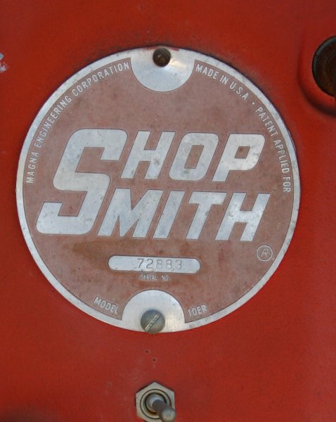

Haven't really started the restoration on the ER10 yet but I have been thinking about how I am going to bring the red color back to the logo nameplate. You can see in the pic that it is very faded.
[ATTACH]4589[/ATTACH]
Polishing compound DID NOT improve it. I tried it already.
The raised lettering is only .005" tall. I don't know how successful painting will be but then I have no idea of any other way to make it red again.
I wonder if it was originally painted or if it was a low viscosity ink.
Any ideas are welcome.

mickyd wrote:Haven't really started the restoration on the ER10 yet but I have been thinking about how I am going to bring the red color back to the logo nameplate. You can see in the pic that it is very faded.
Thinking back to my youth, I was working for a steel fabricator which was doing work for an engraving company. This 'plate' is similar to those used in that time frame(1950's). They were made by photo etching away the parts 'to be painted'. I do NOT recall totally, but I believe they also left the photo resist on until after painting. The paint on top of the resist was removed,by buffing I believe since the resist would not adhere as tightly as the paint. They did a LOT of buffing/polishing there.
This is REALLY foggy memory here, and as I was NOT actually involved myself in the process, these observations/conclusions may be incorrect. However my 'mind' was MUCH sharper then! Amazing the half century old somewhat trivial stuff 'stored' that comes out when I cannot remember 'why I came to this room and to do what'!:D
I do remember how to exit the room however - So there IS hope yet!
BTW they were processed in 'sheets' and were punched out LAST.
dicksterp
Posts: 165
Joined: Sun Jun 15, 2008 1:12 am
Location: Ft Wayne, IN
Post by dicksterp »
Mike,
You might wander over to http://www.owwm.com and check their forum boards. Some of the members there have made new badges by photo etching.
Dick

dicksterp wrote:Mike,
Thanks for the suggestion. I didn't remember to post there. Getting a little scrambled juggling 4 different forums. I got a quick response from a couple of guys on how to best proceed so I am going to post links here and edit / add as they come up.
Here's my original post with them:
http://www.owwm.org/viewtopic.php?t=56036
This thread discusses removal methods and reconditioning the badges.
http://www.owwm.org/viewtopic.php?t=21710
Sunny San Diego

I've decided that I am going to attempt to recreate a logoplate using a chemical etch process similar to the way a printed circuit board is made. The original was most likely made with either a chemical etch or a photo-etch process. Both processes do the same thing. The difference is that way that each “masks” the surface prior to going into a chemical that etches the unmasked material away, leaving the lettering raised.
If you interested in seeing generally how it’s done, check out this 1 minute you tube clip: http://www.youtube.com/watch?v=8fBlYEKqsRo
I am still going to try to paint the existing faded logoplate just to see how easy it will be to restore one of these things. The method I’ll try is spraying the entire face with red Rustoleum then sanding it on a flat surface with ~1000 grit sandpaper.
Sunny San Diego

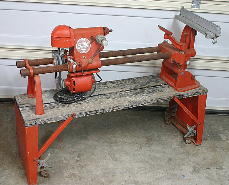

Well, the restoration journey has officially begun. I've spent a couple hours the past two nights disassembling and in several areas failing miserably to do so. First pic is to remind you what it looked like as purchased.
[ATTACH]4839[/ATTACH]

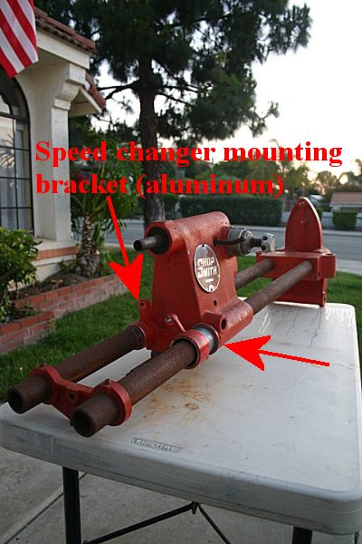

This thing is INCREDIBLY rusty. Nothing moves on the way tubes, even with a persuader. I tried sanding away the way tube rust on one end of the headstock to see if I
could get any movement. Nothing, even with persuasion again. Next pic is just to show you that I really AM working on it. This assembly weighs 90 lbs.
[ATTACH]4836[/ATTACH]
My plans had been to put the whole way tube assembly shown above into the electrolysis tank as is but I can't because of the speed changer being aluminum. Aluminum is sensitive to electrolysis and its recommend to only expose it for about 15 minutes and then check frequently for any signs of slight pitting or discoloration. That just won't work. I'll probably just stand the thing up in a plastic kitchen garbage container and fill it with the electrolyte solution (washing soda and water) to just below the aluminum parts. I'll take any suggestions on how I am going to get the speed changer component to budge from where it is over to the cleaned tube.
Here's some other pics that shows the severity of rust. In this next picture, I am unable to get the aluminum caps on the end of the quill feed off. Soaked them in WD just to see if that helps. I'll know tomorrow.
[ATTACH]4838[/ATTACH]
This picture below really shows how heavy the rust is on the way tubes and other metal parts.
[ATTACH]4837[/ATTACH]
