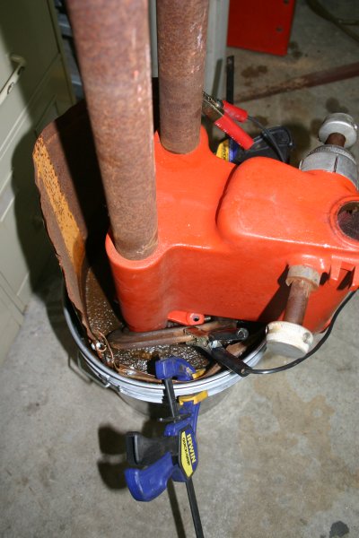

Giving the ER10 a "cat bath" tonight. I'm doing this localized electrolysis to give the frozen tie bar, speed changer, and headstock a clean surface to slide on once I unfreeze them with "Kroil" penetrating liquid next week. The end is submerged in the washing soda / water electrolyte solution to about 1" below the level of the aluminum speed changer. This is because electrolysis process can pit the aluminum.
[ATTACH]4848[/ATTACH]. . . [ATTACH]4849[/ATTACH]
[ATTACH]4850[/ATTACH]
You'll notice the important battery charger lead connections. It is absolutely critical that you get this right
- Black negative lead on battery charger goes on the item you want cleaned. In my setup, I am connected to a C-Clamp that is tightened onto on of the way tube. I did a localized wire brushing of the way tube in order to remove the rust where the clamp makes contact to ensure good current flow.
- Red positive lead is connected to the sheet metal electrode. I always use sheet metal vs. rebar or thread rods shown on a lot of internet website on electrolysis. It had a much greater surface area so the rust that it removes gets spread out over a greater area. Use rebar and one, it takes longer and two, you have to clean off the rebar because the rust buildup on them reduces the effectiveness.

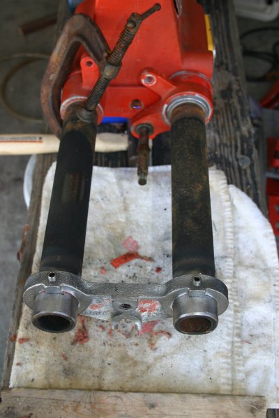

The electrolysis process ran overnight cleaning the rust off the tie bar end of the way tubes. As you recall, I could only submerge the tubes up to the aluminum speed changer since aluminum cannot safely go into the solution. I checked after 15 hrs and the tubes were free of rust.
The shot on the left is what they looked like immediately after taking them out. Notice that the electrolysis also works great as a paint remover!! The tubes are still covered with black oxide residue that brushes off real easy. On the right, I cleaned the tubes but only up to the tie bar with a brass wire wheel mounted on a drill. I was then able to tap the tie bar with a hammer and wooden block alternating side to side to remove it. It came off pretty easy.
[ATTACH]4864[/ATTACH]. . .[ATTACH]4865[/ATTACH]

So, I cleaned the way tubes all the way up to the speed changer. I was curious to see if it would budge since the tubes were now rust free all the way up to it. If I could move it, I figured I could get it off without the "Kroil". I set up a bunch of wooden wedges between the headstock and the speed changer and started gently tapping them with a hammer.
[ATTACH]4866[/ATTACH]
As I tapped, I noticed the gap opening up. What I thought was the speed changer moving actually turned out to be the headstock. Even though I hadn't removed the rust from the tubes on the other side of the headstock, it was actually moving in that direction. As it moved, the tubes under it (on the speed changer side) were rust free. Makes sense since the headstock was protecting the tubes from the weather. I then started pounding the headstock only with a 2x4 and mallet. Got it to move about 6" pretty quickly. That gave me room to be able to tap the speed changer down near the way tube with a 2x4 and mallet in the opposite direction toward the section of the way tubes that went through the electrolysis. It wouldn't budge however. Remembering what farmer had said previously about tapping it in the opposite direction, I tried that, tapping it toward the headstock. IT STARTED TO MOVE!!! The more it moved, the easier it got since it was moving onto the clean tubes that were protected under by the headstock. Underneath the speed changer was nasty thick white corrosion. Eventually, the speed changer was completely onto the clean section of tube and was moving by hand. That gave me a chance to clean the white corrosion off the tubes and try sliding the speed changer back were it came from. It slide right over the spot where it was previously frozen. SUCCESS!! I was able to get the speed change off the way tubes!!! Since I felt lucky, I also tried removing the headstock. Although it didn't move quite as easy, it moved with gentle persuasion with the hammer and 2x4. I got it it off with only a little effort.
[ATTACH]4862[/ATTACH]

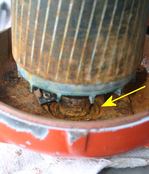

Since I have room in this post for one more photo, thought I'd show you what my rear motor bearing looks like. I think that is DEFINITELY going to take the "Kroil" to dislodge it from the housing!!!
[ATTACH]4863[/ATTACH]

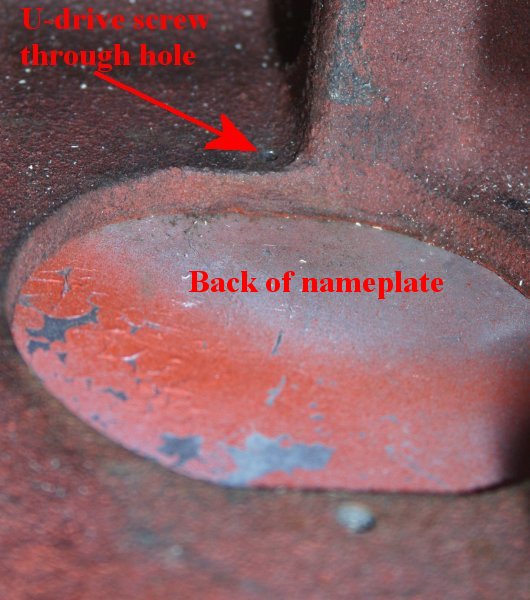

Removing logoplate aka nameplate aka badge from headstock
Since I am going to recreate the ShopSmith nameplate, I needed to remove the faded one currently on the machine. The nameplates should be held on with two U-drive screws.
[ATTACH]4869[/ATTACH]
Mine only had one on the top and a machine screw on the bottom. Somewhere in it's genealogy, a previous owner felt the need to have access into the headstock so they drilled and tapped a hole for the screw.
The U-drive screws can be a challenge to remove since the head is a round head with no slot or cross recess (aka phillips) drive. To get them out, you need to either drill them out OR push them out from the inside if there is an access hole behind it. In my case, there is a 1/8" diameter access hole as seen in this photo looking UP into the headstock.
[ATTACH]4868[/ATTACH]
Since there is no room up inside the headstock to get a swing, most people probably grind a flat on the head and drill the head off then push it through. This can be a chore and a drill killer since the screw is hardened.

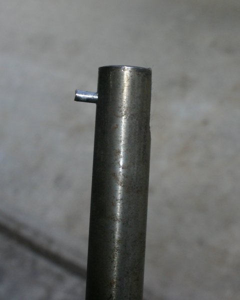

I made a tool where I could go up inside the headstock and push the U-drive screw out with a wedge. The tool is a 3/8" piece of drill rod at least a foot long with a 3/32" hole drilled into it. Into the hole, I hammered in a 3/32" spring pin. Looks like this.
[ATTACH]4870[/ATTACH]
You place the tool up inside with headstock an position the spring pin so that it is in the access hole. Next, you take a piece of 2x4 that has a slight wedge shape cut into into it along with a relief and place it behind the drill rod.
[ATTACH]4871[/ATTACH]. . . [ATTACH]4872[/ATTACH]
From here, you just strike against the butt end of the 2x4 and the wedge does the work for you. It drives the U-screw out far enough where you can then grab it with a pair of vice grips and pull it out. It's shown in the next post. (I hit the max of 5 images in 1 post.)
