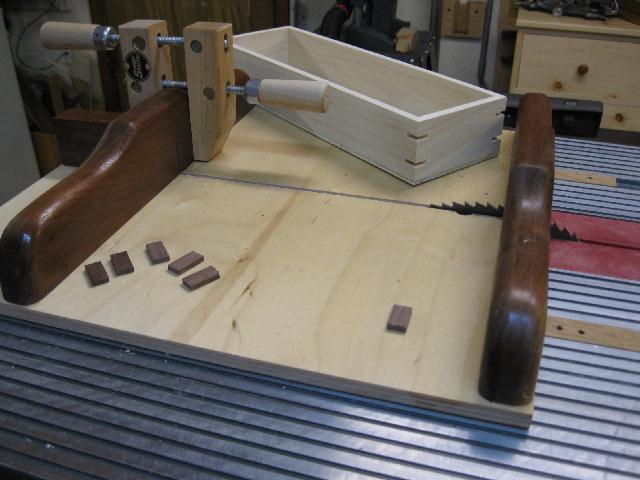

Cutting 1/8 by 3/4 in stock is done with a 110 tooth steel blade and sliding crosscut sled that provides a safe and clean cut. Keys for a small box to reinforce the mitered corners is shown[ATTACH]4900[/ATTACH]
Showing your method of cutting small pieces safetly on the table saw is appreciated, Rock!
Very nice looking sled - Your use of the hand clamp to hold the keys, makes it very safe. Thanks for the photo!
