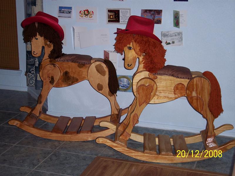

There is another method that I haven't seen mentioned yet.
If you have a program like photoshop or paintshop pro you can load the image and re size it there.
I use paintshop pro. I crop the image to just the graph area then resize and print it out scaled to actual size. For this picture that would be 17" X 35". Paintshop pro let me do this for the rocking horses I did for the grandsons and those are the patterns I worked from. I did have to tape them together but that isn't an issue for me and in my case it is a program I already own. I am sure many other paint programs will let you do this too.
[ATTACH]5171[/ATTACH]
Just for clarification I am not affiliated with the maker of Paintshop Pro. Just a User.
