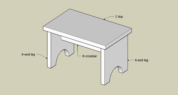

I have completed lessons 1 and 2. I think I did it right and will try to help Tom answer any questions.
[ATTACH]5281[/ATTACH]
I want to personally thank Tom for all the hard work he has put into this study course. We should all make the most of it, it is not every day a person with his abilities is ready and willing to help.
Mark

mbcabinetmaker wrote:I have completed lessons 1 and 2. I think I did it right and will try to help Tom answer any questions.
Mark - could you please include your attachment in your post. Get invalid link when trying to view.:( Thanks.

lv2wdwrk
Sorry for the attachment. I have had some computer glitches of late.
[ATTACH]5282[/ATTACH]
This is what I was trying to do.

lv2wdwrk
Posts: 406
Joined: Thu Jul 20, 2006 9:40 am
Location: SWMO
Post by lv2wdwrk »
Thanks Mark. Looks good.
Don't try to make sense out of nonsense!

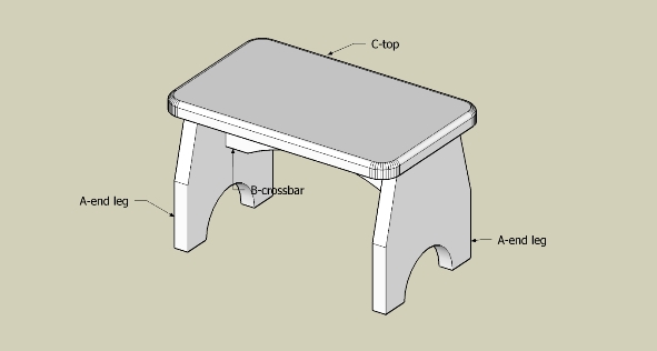

I have to admit that lesson 3 was a little more of a challenge. Every thing went fine until I was trying to put the top back together. One small mistake led to having to delete and redraw the top and start that part of the lesson over. Here are some tips from my mistakes. I didn't get the 2 halves completely butted back together. Make sure you have a thin line when finished before the final deleting to make the top 1 piece again. Here I found that it is better to use the pan and hand tools from the tool bar rather than using the mouse which I usually do.
[ATTACH]5283[/ATTACH]
In the end everything turned out just as it should. I am really enjoying these lessons and learning a lot.
Lesson 3 resized.jpg (32.71 KiB) Viewed 7481 times
Mark

My apologies to Tom and the group. I got so carried away with this that I jumped the gun and posted the above on lesson 3 before Tom released it. Oh well just call me the Teachers Pet.:D He is making a few changes and will release it to the group shortly.
Edit*****I think the videos work great!
