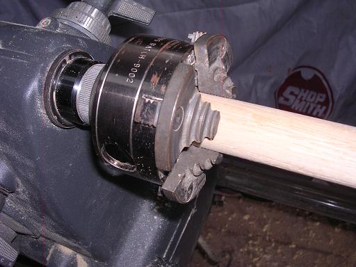

A scroll chuck is usually used to hold a bowl for turning, if you don't use a faceplate. However, it can also hold a square of round piece for spindle work. I have just used my Oneway Talon chuck and the Shopsmith lathe duplicator to duplicate 29 "finials" for a person who is restoring the gingerbread on a 150 year-old house. It would have been tricky to turn those between centers. I'm sorry, but since I delivered the job yesterday I don't have any pics of them.
Here is a pic of my chuck holding a 1 1/4" dowel:
[ATTACH]5302[/ATTACH]
I have installed accessory jaws that are small enough to hold this dowel because the standard laws would not hold something this small. Most chucks have a wide range of accessory jaws available.
I have included a link to the Oneway chucks page of the Shopsmith catalog:
http://www.shopsmith.com/ownersite/catalog/l_onewaychucks.htm
A scroll chuck is self-centering. It can provide more than enough grip to hold a spindle if the spur center can't get the job done.
Happy turning!
