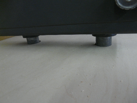

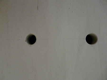

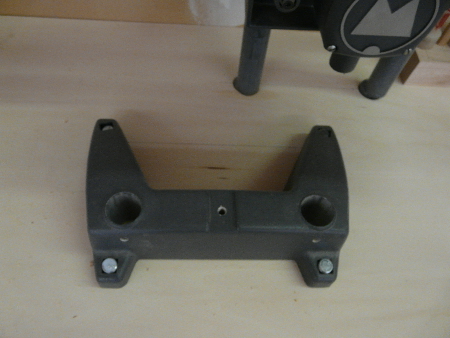

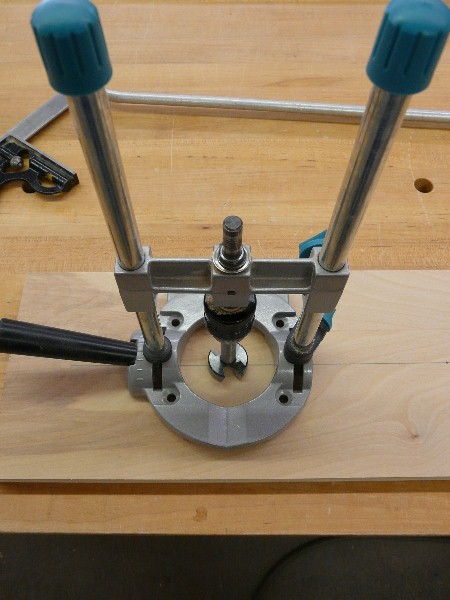

Affyx and other interested parties, this is my attempt at describing how I drilled the holes in my SPT storage benches. As previously stated they are 1 1/4 inchg holes. SPT holes need to be 7 inches on center, Mark 5 main tables 12 inches on center and 510/520 main tables 15 1/2 inches on center.
[ATTACH]5637[/ATTACH]
[ATTACH]5638[/ATTACH]
This is showing the band saw in place and then removed. Look closely and you can still see my lay out line. Also notice that I have routed a small round over at the top of the holes.

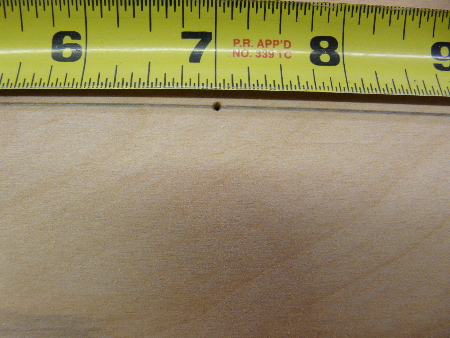

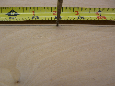

This system requires very accurate measurements. I draw the lay out line and then pull my tape and lay out both holes at the same time. Here I mark 7 inches and 14 inches with an awl.
[ATTACH]5641[/ATTACH]
On smaller pieces you can drill on the SS. My pieces required drilling after assembly and I used this drill guide from Woodcraft. The holes would be very hard to keep straight without some type of guide. I have not had a problem with fit but if you get one to tight you can always ream the hole out with a 1 inch sanding drum in a drill. I recommend a sharp forstner bit and I use Freud Precision Shear Forstner Bits. http://www.freud-tools.com/frprshfobi.html

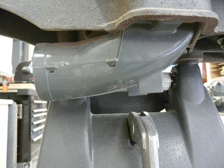

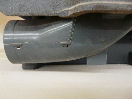

The jointer will not work with this system if it is fitted with dust collection. I handled it with the SS SPT base.
[ATTACH]5643[/ATTACH]
[ATTACH]5644[/ATTACH]
