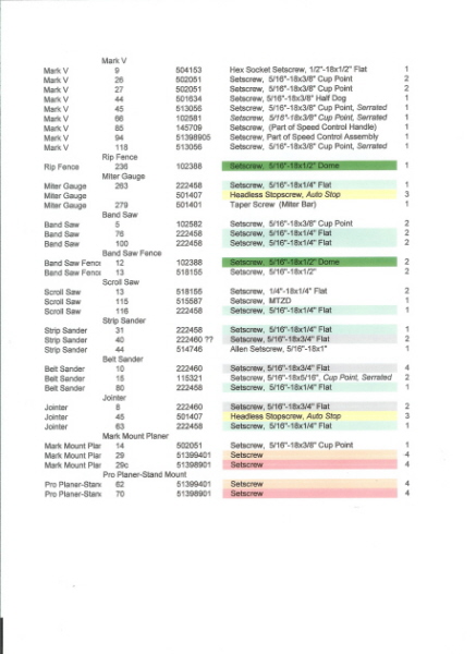

Maybe this will help. This is a compilation of information taken from the Shopsmith Parts Lists.
PS Sorry for the poor quality. I had trouble converting the file format and this is the best that I have gotten, so far.
[ATTACH]6487[/ATTACH]
- Shopsmith Setscrews Version 4.jpg (81.35 KiB) Viewed 5989 times

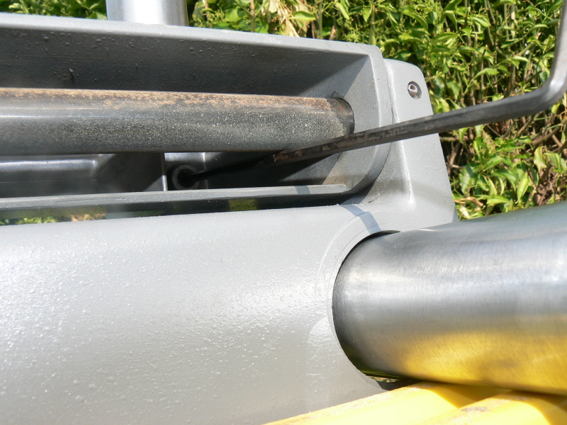

Which 'end' did it 'fall' from? If the tailstock end, I would look to see if the way tube set screws are Both still there. They are not only difficult to see, but also difficult to access and tighten.
[ATTACH]6490[/ATTACH]
The pix shows a bench tube in the lower right corner and the way tubes raised into vertical position in the upper left corner.
There is a set screw holding each way tube back under the 'hinge pin'.
- BASE REASM HINGE PROBLEM.jpg (299.39 KiB) Viewed 5979 times
