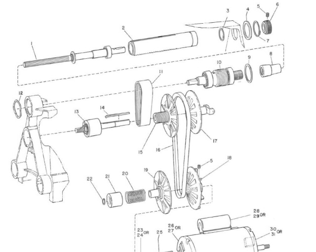

As for the Speed Control Cam I have tried to look in the parts book for it and have not found it list as that. are you talking about the
I am assuming these are the two Sheaves that I am talking about and not the two that are actually mounted to the Electric motor shaft. Which i did not notice were made of plastic or metal.

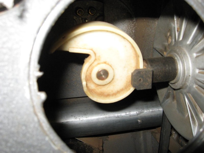

The "cam" sticks straight out the back of the speed control dial and as the dial is turned the cam puts pressure on the device that controls the variable speed sheave. Frankly as I made limited use of the Mark VII I believe I like the Mark VII speed control better than the Mark V. Of course if I was using it a lot I might look at it differently. It "was" intended as an improvement over the Mark V...

Stole this photo of the plastic Mark VII cam off farmers online photo album. Don't tell him.:D
[ATTACH]6626[/ATTACH]
This definately appears easy to duplicate if anyone had a trace or dimensions. Can anyone post either?

mickyd wrote:Stole this photo of the plastic Mark VII cam off farmers online photo album. Don't tell him.:D
Don't worry, I won't tell him... :D :D
If I get a chance I'll pull one and trace it but it may be a while before I get that much time. I have a lot of engine work and tire work to get done over the next couple of weeks.

robinson46176 wrote:Don't worry, I won't tell him... :D :D
Thanks for the trace offer and also thanks for not telling him about the theft. He's a pretty big guy and I wouldn't want him hunting me down!!!
Sunny San Diego
Looking at the cam pix I notice what appears to be a 'pop rivot' head on them back side of the way tube. I assume this originally secured the 'rack gear'.
[ATTACH]6637[/ATTACH] The Control Sheave is # 17

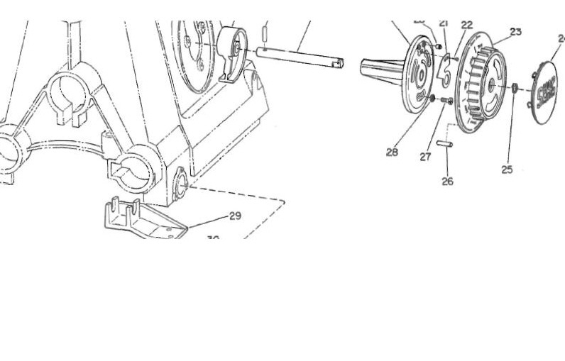

[ATTACH]6638[/ATTACH] The Cam number is not shown.
These parts are NOT available from SS Inc. Therefore the reason they are a "problem".

I ordered the mark VII info package from shopsmith, which had a drawing with all measurements for the machining of the cam. It was 10$ well spent for parts list etc.
