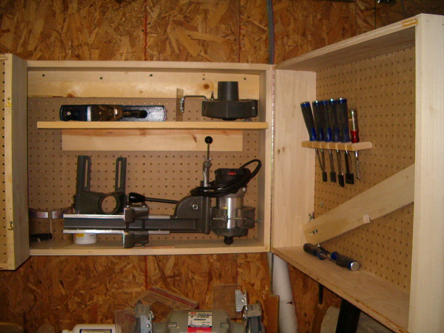

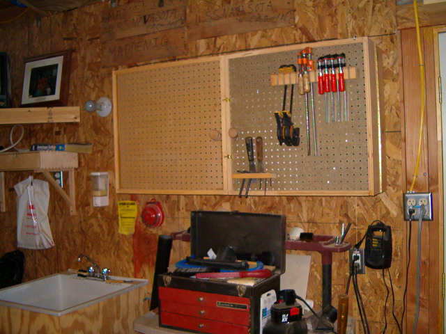

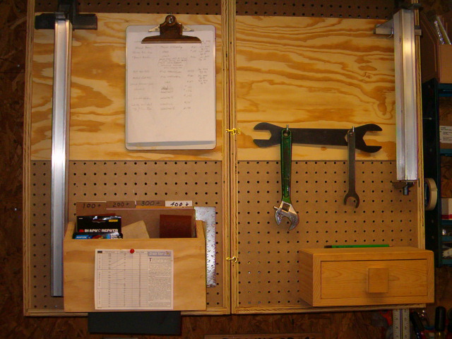

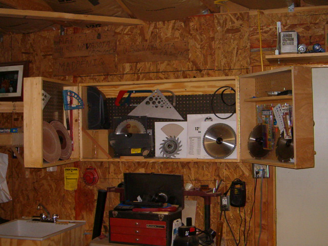

Geez! Once again, my ignorance has been bliss!:) Never even thought that I should search for hinges that were stouter than what was easily available. Since I never needed a piano hinge longer than 4 feet, I have always bought mine at a local hardware or one of the big box stores. They always served the intended purpose of holding chest lids, and large cabinet doors secure and straight.
The only special consideration I gave to attaching the hinges was to drill the screw holes using a self centering bit - then first inserting a steel #4 screw in each hole then removing it before installing a #4 brass screw. Yes, I used beeswax on all screws. Oh Yeah! When buying those local, packaged hinges, it works best to discard the packaged screws and buy replacement brass screws - and be sure to use a #1 Phillips screwdriver.
All cabinets in the attached photos have 1.5" wide hinges. The cabinet doors successfully support quite a bit of weight.
Larger cabinet inside half.jpg (128.88 KiB) Viewed 1137 times

Chuck
What a deceptive way to show off your cabinets by telling us you want to show us their hinges:D
I think you have posted them before and they look great! I know you had sent me pictures of them when I was redoing my shop.
