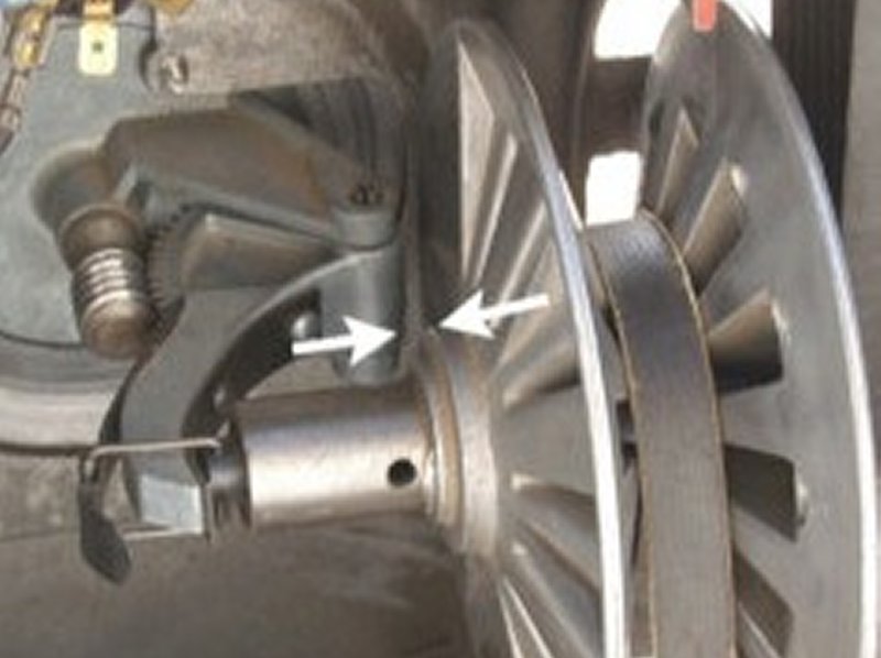

Here's a photo of what it should look like. Can you describe what your seeing? Oh, and PS, welcome to the forum. It's a slow day today so be patient. You'll get plenty of help, I assure you.
[ATTACH]6934[/ATTACH]
- good speed control.jpg (53.84 KiB) Viewed 6630 times

Lets see if I understand your 'description'.
1) With the belt on the motor pulley the motor stalls when trying to start.
2) With the belt off the motor pulley, the motor runs.
3) The chuck turns freely. Is this with the belt ON the motor pulley?
4) Sliding the loop off the quadrant gear will not 'help' it run free.
If turning the 'chuck' is turning the pulley on the idler shaft, it should be possible to run the speed control up while turning the 'chuck'.(the disc sander makes this easier to turn by hand) This will not change the sheave adjustment unless the loop is back on the quadrant gear arm(the leaf spring)
Howsomeever, One thing needs to be determined first. With the belt off the motor pulley, can you pull on the belt so as to make the idler pulley rotate(freely) more than one revolution? I am guessing it will not!
If it will not, the belt has dropped down too far into the idler shaft sheaves. In order to free it, the sheave must be moved toward the quadrant gear.
Is the belt less than 1/2" wide at the outer surface?

Yippeeeeeeeeeee
Thanks to both of you.
I seem to have it running... Yippeeeeeeeeeeeeeee!
Not totally sure what happened but it seems like the speed controller dial was off of the telling me extactly where the quadrant gear really was and I was running it into the idler without knowing.
By turning the chuck by hand and running the speed controlloer back up and down it has seemed to get back to giving me an accurate reading and allows everything to turn freely.
I don't know if this makes any sense. As long as I have it apart I will go through the manual and clean and lube everything they say I should.
Let me know if you think there is anything else I should look at.
Ralph
Ralph

rralmond wrote:Thanks to both of you.
Ralph
Ralph,
Make sure to follow #13 on this page.
http://allinonewood.com/?page=shop/serviceadvisor&
Watch this too.
http://www.shopsmithacademy.com/SS_Archives/SS117/SS117_Replacing_Speed_Changer.htm
You need to make sure that your speed control can't crash into you pulleys.
