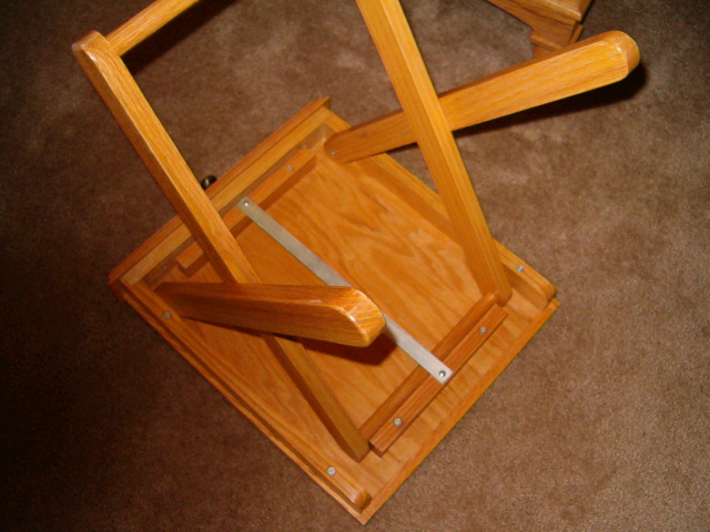

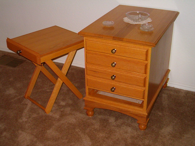

Maybe these photos will help end any confusion.
Yes, the drawer fronts are, in fact, part of the trays.
In both of these pics, you can see the drawer fronts and pulls are attached to the trays. The trays slide into the openings of the case almost as closely as the drawers.

The drawer fronts on "Norm's" chest look to be about six inches high. IMO this would be a large piece to be attached to a tray. The drawer fronts on the Snack Tray Cabinet are only about 2 1/2" high.
Of course, if you wish, you can make some trays (without the drawer fronts)and store them in any drawer that is large enough. A clothes dresser would work. Perhaps you could fit more than one tray in a drawer.
Another consideration would be the depth of Norm's dresser. The Snack Tray Cabinet had to be about 25 inches deep in order to accommodate the folded legs of the trays.
