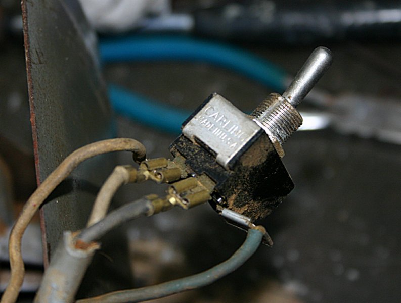

Maybe this photo will help you.mmorris wrote:When pulling the motor to rewire it with #12 wire, I accidently pulled BOTH wires from the switch (MV#268502, 1954 w/ upgraded 1 1/8HP motor). Therefore I know not which wire goes where on the switch. If I get it wrong and reinstall everything, the motor may possibly turn the opposite direction that it should. I can try it on the bench before installation if I knew for sure which direction the motor is supposed to turn while in situ. I'm assuming clockwise, but I know what happens when one ASSUMESHelp?
[ATTACH]7311[/ATTACH]
- Img_4874mod.jpg (62.3 KiB) Viewed 8434 times

I started taking my Mark V apart for renovation and managed to nearly get the headstock totally disassembled today. I took a picture of the switch and how it was wired before I took the wires off. I also wrapped some blue tape around it and marked a reminder - "W" for the side where the white wires connected, "B" for the side where the black wires connected, "M" for the end where the motor wires (one white one black) connected, and "P" for wires coming from the plug.
Mike's picture out to take care of you. One of his wires looks green, but I only had white and black. Basically the white wires connect to the two prongs on one of the long sides and the black wires connect to the two prongs on the other long side. The two wires from the motor should be opposite each other and the same for the two wires going to the plug.

You can't reverse the SS motor my reversing wires on the switch but you can short out the switch.mmorris wrote:When pulling the motor to rewire it with #12 wire, I accidently pulled BOTH wires from the switch (MV#268502, 1954 w/ upgraded 1 1/8HP motor). Therefore I know not which wire goes where on the switch. If I get it wrong and reinstall everything, the motor may possibly turn the opposite direction that it should. I can try it on the bench before installation if I knew for sure which direction the motor is supposed to turn while in situ. I'm assuming clockwise, but I know what happens when one ASSUMESHelp?
White wires go on one side of the switch and black wires on the other. It's a 2 pole, single throw switch. It's like having a 2 separate on / off switches in one. Each side of the switch is independent. Just don't mix the black and white wires.

The switch has two terminals in the middle of the housing, and two terminals toward one end. The center terminals may point out to the rear or out the sides(mike's switch). Usually the line cord wires(one white and one black) are attached to the center terminals(white on one 'side' and black on the other 'side'. If the motor leads have a white wire, it connects to the 'end' terminal on the same side as the line cord white wire. The remaining motor wire connects to the other 'end' terminal. All GREEN wires should be connected to a metal surface(motor frame, headstock 'chassis'. Different motor models have different color motor wires.
