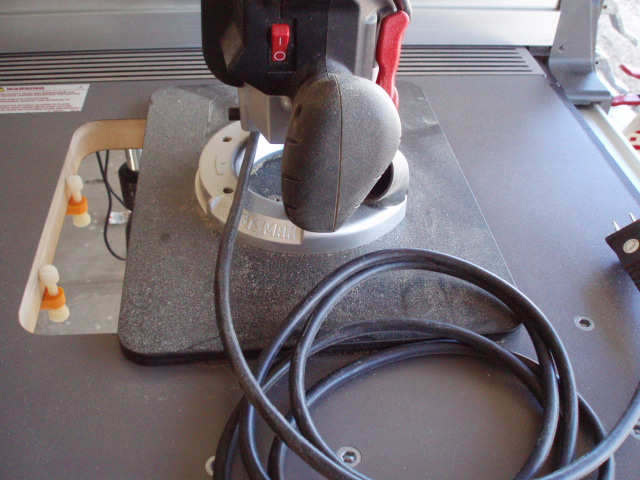

I have some old counter top with 3/4" plywood that I will probably use. After clamping the counter top to the the extension table, I don't think legs are necessary. I do have a shaper fence. Can I use that?

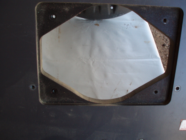

The only router I have is a Sear's Craftsman, about 30 years old. It does have a removable baseplate.
Here is what it looks like from underneath:
I'm going to check out some stores this afternoon, and maybe I will find the answers to my questions.
I need a different baseplate. What do you use for that?
Do you just cut a hole in the top that is large enough for the router to pass through and then do some careful routing about an 1/8" deep to hold the router's baseplate that extends out from the router?
If any of you have any tips on this, I'd appreciate your input.

There are different ways to do this. These images show how both of mine are mounted.

Thank you Dusty for the pictures. The one with the leveling screws really helped me. I think I know what to do now. Too bad it will have to wait until next weekend.
Thanks George for the link. I figured I needed one that was at least 9" X 11" and this one is even bigger. It should work fine with my router.

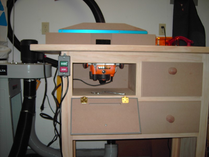

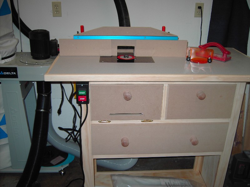

Here are a couple of pics of the table I built. It started out to be a chest of drawers, but I decided that I needed a router table more.

curiousgeorge wrote:Joe,
Very nice router station, George. Very professional looking. Norm doesn't have have anything over on you at all.
That looks good. What did you use for the top, it looks shiny? Where did you get the on/off switch?curiousgeorge wrote:Joe,
