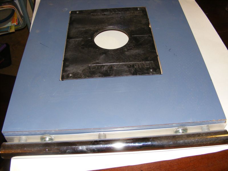

Making a Router Table that fits on my 510

Thanks, Dusty.
Joe,
Thanks to you also.
The top is made of two layers of 3/4 MDF glued together with Formica on the top and bottom. The reason for the Formica on both top and bottom and the wood trim, although MDF is very flat and stable, is to minimize warping from moisture. It makes for a slick surface and is very easy to keep clean. You can write on it with a pencil and it just rubs right off. As for the switch... I don't remember if I got it from Woodcraft or Rockler. Either way there are many safety switches available out there.

What I did was take a counter top from an old video store and made it the same size as the MKV table. Added the extra 510 tubes and now it is a very large work service that will allow me to use the MKV rip fence also.
Not too hard to find extra parts from someone that did the upgrade from 510 to 520

First Prototype of my Shopsmith Router Table
I used one of my left over counter tops to make my first router table.
Here it is from underneath.
This assembly holds it tightly and makes it easy to remove for adjustments.
Here it is from the top spanning the table saw top and extension table.
Here is the underneath view between the table saw top and extension table.
