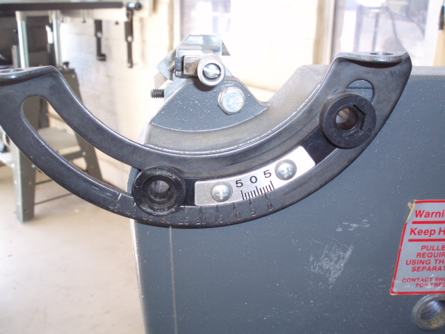

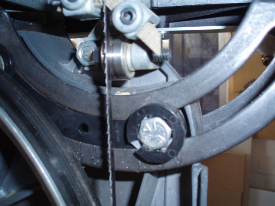

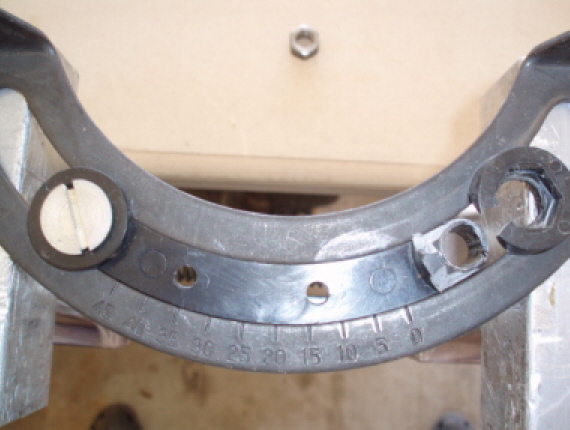

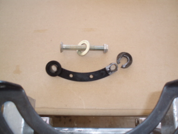

A couple pictures of the trunnion and broken part. First picture is after repair.
[ATTACH]7611[/ATTACH]
[ATTACH]7614[/ATTACH]
[ATTACH]7612[/ATTACH]
[ATTACH]7613[/ATTACH]
