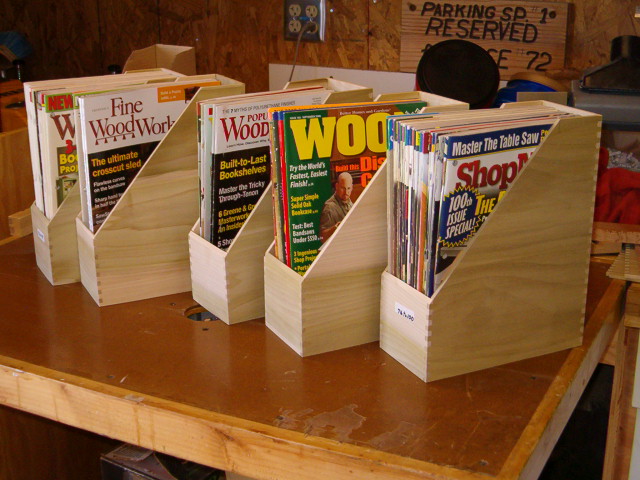

I had better luck with using the simplest of jigs. Used a small hammer to adjust it with taps. Just a piece of wood that fastens to the miter gauge through enlarged holes through the wood. I've found the spacing stud can be narrower than the space between fingers, but the edge of the stud closest to the saw or router bit has to be spaced exactly the width of the saw or bit. - and you need to put some pressure on the piece to press against the stud.
I started out using a brass bar for spacing. With this setup I could make 4 or 5 inches of box joints, but when trying to go longer, the little bit off (probably less than .001") caused the fingers to be off enough to not fit.
A few taps and an hour or so of using up scrap, got the jig so I could make a 13" box joint. (a tap left followed by a tap right followed by ---) Still worked better for me than "screwing around". Al in all I think I saved time by not building a fancy jig. Made magaxine holders.
Used the same jig a couple of months later to build my wood tool chest. That time there were a lot fewer taps, because I drew pencil lines around the miter gauge onto the back of the jig. This time it took only about a half hour to get a box joint 13" long.

- Magazine boxes.jpg (118.58 KiB) Viewed 8104 times

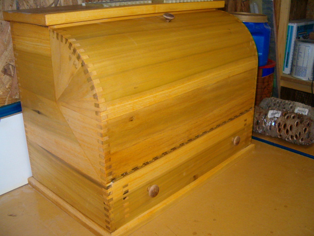

- Outside knobs.jpg (133.27 KiB) Viewed 8094 times
