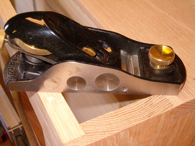

I recently had such good luck hand planing end grain on red oak, thought I'd post this --
The best tool to come into my shop this year is a "bevel up" hand plane. Mine is a small standard block plane from Lee Valley Veritas. The bevel up arrangement needs no chip breaker, and with an adjustable throat, works wonderfully.
The neatest thing about bevel up is - you can change the bevel on the iron and thereby change the angle of attack. With a bevel down plane the angle of attack is dictated by the bed (or frog, I think it's called).
With a bevel up plane and three irons, you can have a smoothing plane, or a high angle for figured wood, or a low angle for end grain. Of course you could get a lower angle with a low angle bevel up plane.
This is how I used mine that I am so excited about. Planed off about a 1/16" in multiple passes on this piece. Man - that was cool!
Of course this photo was posed after the fact.
[ATTACH]7933[/ATTACH]
I'm sold and am going to save up for a low angle plane. If the standard plane works this good, a low angle has to be super. Lee Valley now has a handle that can attach to a block plane to convert it to a smoothing plane.

Correct me if I'm wrong but I thought all block planes were bevel up planes.
I have two and I mount the blades in both bevel up. One has an adjustable throat opening which I love on end grain.

Ed I don't know about all but the 3 Stanleys I have are all bevel up #60 1/2 block planes. I should have said that I really wanted the higher quality Veritas® or maybe a Lee Nelson skew plane with the fence attachment***********or both.
