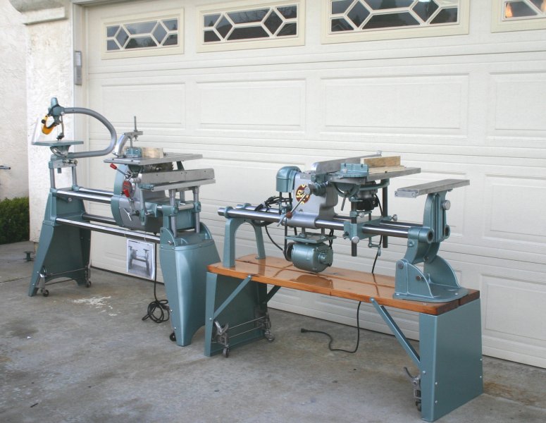

Spent the entire day yesterday OUTSIDE working on the project. (sorry to rub it in Rest Of Country, USA ) Had to work in between two quick passing sprinkles but in general, sunny and a real nice day to be out there. That's the nice thing about these ShopSmiths. No dust collection system in place? Wheel 'em outside and use the ground as your dust collection system! Had both the Mark 5 and ER setup. The 5 for the table saw, ER for the undertable router. Got a lot of slow drive bys from guys looking at the machines. :D
[ATTACH]7975[/ATTACH]

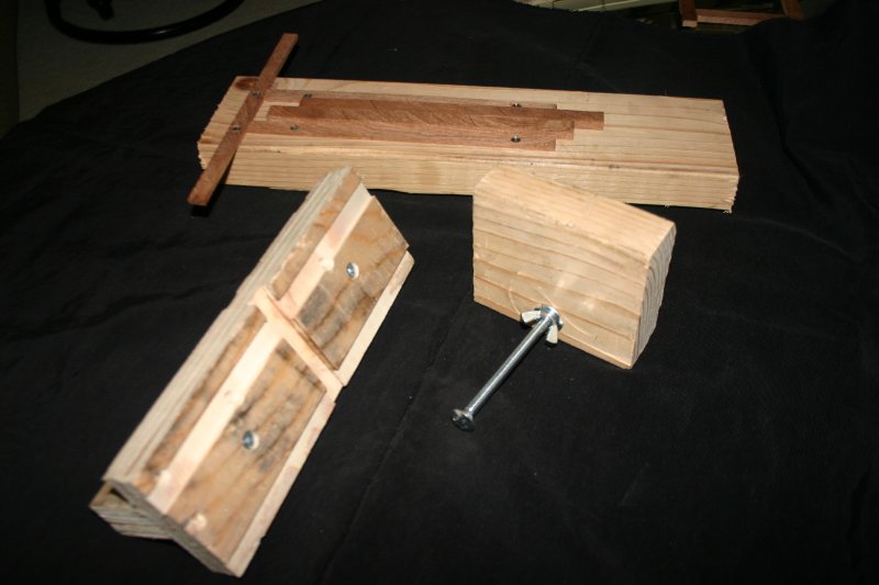

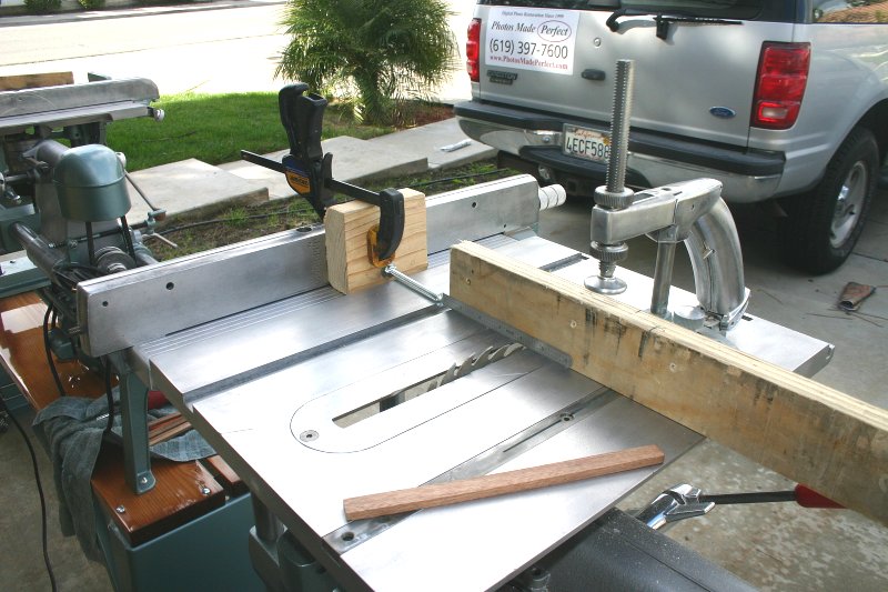

Most of the day was spent making up the 'stuff' I need to do the project. Made up the router table insert, router fence guard, miter gage
extension, adjustable stop block, the router jig for nesting the small pieces, and a hand planing station. Here's the last three of these.
[ATTACH]7976[/ATTACH]
[ATTACH]7977[/ATTACH]

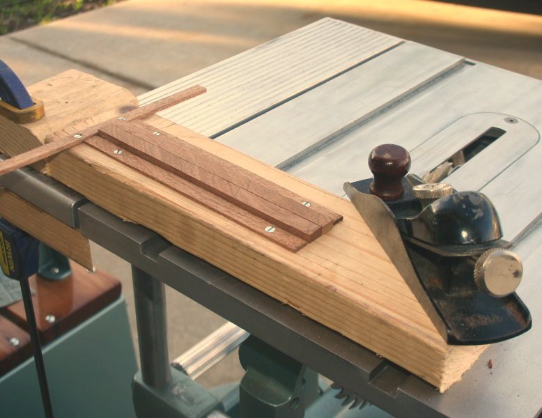

Since I resawed the wood to get the 1/4" thick pieces, I had to hand plane them to get them down to .250". They were about .280" so I made up a quick planing station and did it the old fashion way. Since all the sides are half lap joints, I wanted to make sure they were as close to dead on as possible since any error is doubled when you put them together.
[ATTACH]7978[/ATTACH]

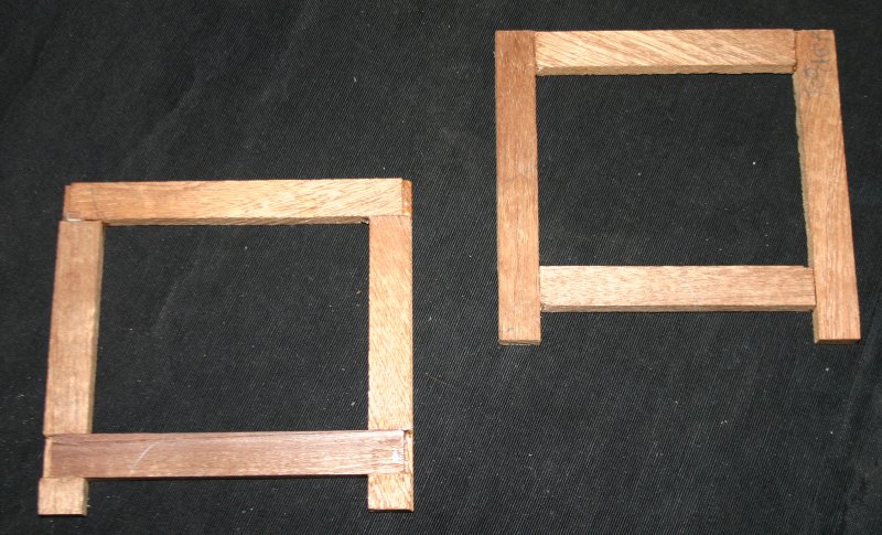

I decided to make a complete lantern before I finish cutting up all the pieces I need for the other two. Could save me from making a lot of scrap. It will either be considered a prototype or lantern 1 of 3, depending on how it comes out. Managed to get the sides glued up for the smallest version. Here's two of the four showing the outer and inner surfaces. Still have the 45 degree chamfer on the corner edges to do along with the 1/8" groove to hold the base. I'll tackle the rest of the pieces for it today and hopefully have a completed assembly.
[ATTACH]7979[/ATTACH]
Feel free to critique if you notice anything.
