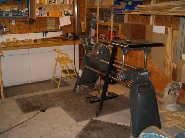

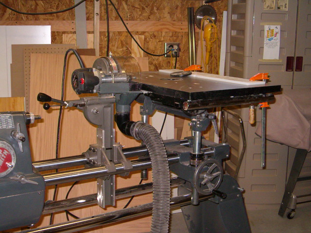

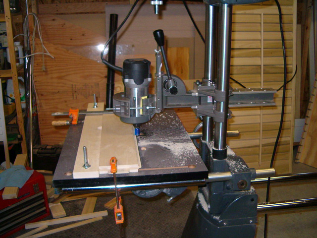

I consider my Mark V to be well cared for and to be in "excellent" condition but my tubes are not near as well kept as charlese' seem to be. I think this is evidence that 1) the tubes are not all the same and 2) not everyone cares for them the manner.
I wax regularly and I have no rust but I do not have the chromium appearance that charlese' tubes present.
Disclaimer!
Ah Geeze! As I searched through my shop photos to find any pics of the machine tubes - found they were really scarce. The subjects of the pics are usually made of wood and the machine is incidental.
The photos make the way tubes seem shinier than they really are. My waxing schedule is once a month, or when they develop a little resistance, whichever comes sooner. (usually the resistance thing)
As said earlier, the bench tubes have never had any care other than vacuuming. They have a chromium finish.
I seriously doubt Dusty's way tubes have ever suffered any abuse. A photo would probably make them look quite shiny.

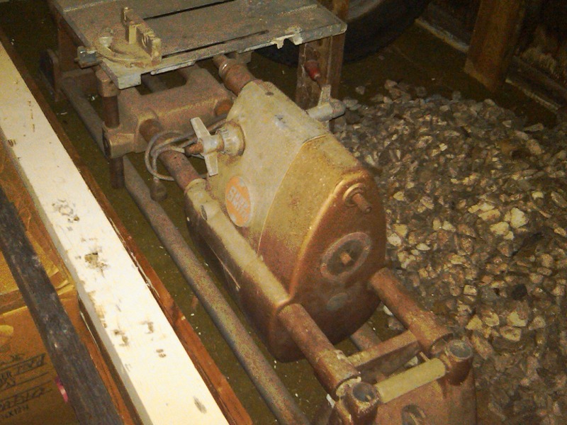

I recently acquired my dad's 1962-63 Brownie and hope to return it to service. It's been sitting for 20+ years in a humid garage and the way tubes are covered in rust and have sustained pitting along their entire length (see attached photo). There is some surface rust and limited pitting on the bench tubes. I'm concerned about removing too much material during rust removal and I doubt I will be able to maintain the original dimensions.
My question: Especially for the way tubes, must they be replated in chrome to maintain their original diameter or will buffing compound and paste wax suffice? Most people on the forum appear to use a wire brush and sand paper on the way tubes but wouldn't that affect the tolerances and how well the headstock slides along them?
I want to keep as many parts original on this machine as possible, including the tubes, especially since it has sentimental value to me. But I'm also wondering if it may not be better to simply pick up a set of tubes in good condition from eBay.

Welcome the forum ddvann79. I wouldn't be concerned about the dimensional change of the tubes after rust removal. The dimensional change after rust removal will be negligible. At most, you'll loose a couple of thousandths of an inch. When locking down the headstock, the wedge locks press against both tubes, making the OD of the tubes less important.ddvann79 wrote:Gentlemen,

You may want to consider using electrolysis on your tubes to cut down on the physical labor. If so, I can direct you to a few posts that deal with it.
Sunny San Diego
Sunny San Diego
mickyd wrote:Welcome the forum ddvann79. I wouldn't be concerned about the dimensional change of the tubes after rust removal. The dimensional change after rust removal will be negligible. At most, you'll loose a couple of thousandths of an inch. When locking down the headstock, the wedge locks press against both tubes, making the OD of the tubes less important.
Mickyd likes electrolysis for way/bench tubes, I prefer evaporust for all tubes. The evaporust will also clean up the inside of the tubes. Evaporust is good for derusting small parts(toss em in a bowl/jar overnight).
Both electrolysis and evaporust stop after all the iron oxide has been eliminated so excess time is not a problem(start it and come back when yer good and ready).
The electrolysis is a good method for sheet metal and any really really badly rusted parts(it does a good job of removing paint at the same time).
Citrusstrip works well on aluminum parts.
Sanding/grinding/naval jelly will also attack the 'good' material that remains. Save the sanding for 'polishing' step.
