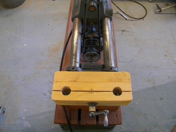

On the topic of SPT's on 10ER's, the one I picked up and restored over Christmas had the rather ingenious setup shown below:
[ATTACH]8172[/ATTACH]
[ATTACH]8173[/ATTACH]
The outer pulley was simply bolted to the existing pulley and a short shaft machined to take the drive coupling was inserted in the pulley and locked with a set screw. The tool mount is self explanatory. If, at first glance, it doesn't seem very strong, think a second about the little plastic coupling it's driving. If you want to see more of this 10ER: http://picasaweb.google.com/paulm549/10 ... directlink
Paul M
