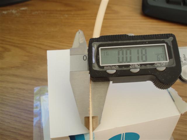

I don't know. How thin should I be able to get?
[ATTACH]8719[/ATTACH]
1/64"
Hey, this is a wood working forum. I thought we weren't suppose to worry about measurements in the thousandths????
P4260002 (Small).JPG (35.75 KiB) Viewed 4205 times

dusty wrote:I don't know. How thin should I be able to get?
When you can read through it I would quit... :D

dusty wrote:I don't know, JPG. I'm not seeing what you say you see. No evidence of operator error here.
The top pix is labeled 1/16".
The lower pix is labeled 1/32".
The top pix appears to be thinner than the lower one.
OK OK OK So ya 'fixed' it! Anyone who is confused, check the quotes of the 'original' post!!!
dusty wrote:is not a difficult task. The operator must pay attention to detail, however.
Actually, I do not know exactly what I did to eliminate my symptoms of a drafting bamd.
I still have the same blade and the same cool blocks installed and the cool blocks have not been adjusted.
I did have the blade off so tension might be different. I know for certail that the cool blocks have been lowered to just above the stock being ripped AND
I am using a different fence.
I have a low profile fence attached to the table right now so that I can rip real thin pieces. Cutting thinn pieces I could not get the cools blocks low enough with the regular fence.
CONCLUSION: As someone has already implied - OPERATOR ERROR.
[ATTACH]8718[/ATTACH]
1/16" thick
[ATTACH]8717[/ATTACH]
1/32" thick
Notice the pix have been reversed!!!!:rolleyes:
Ed in Tampa
