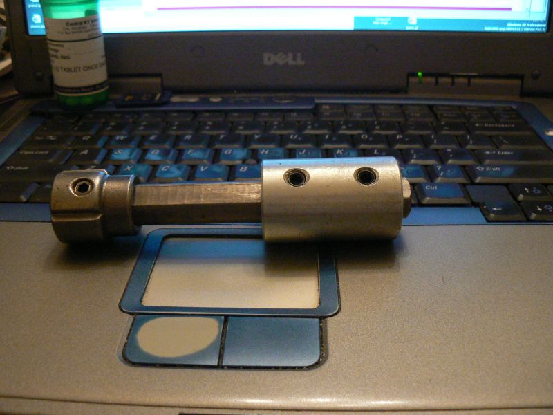

Has anyone ever thought of the idea of a extendable power coupler? So that when you get the table saw all set up the way you want and you maybe want to remove the jounter,band saw, ect you don't have to move the table saw set up. It would be neet to slide the coupler together and remove the SPT.

I fabricated a regular coupler that unscrews in the middle (has to have left hand threads) to disconect a SPT without moving the headstock. It will work but I am still not happy with it. You could make a longer telescoping shaft much like a scaled down tractor PTO tumbling shaft but it would present many of the same dangers the tractor ones do and would need very careful guarding.

It wouldn't necessarily have to be longer. The standard coupler length could be collapsed about 1 inch to be able to get it off the hubs. I know that this would take some work. But I would think that if Shopsmith would ever look at this idea I believe it would be a hit. Just a idea!

In those discussions, a 5/8" sleeve coupling(or a 1/2" router adapter) were used with a short piece of shaft to allow mounting a ss hub. Consider the ss 1/2" router adapter. If a shaft(1/2") of sufficient length is used such that when slid in/out of the adapter, it changes the overall length sufficient to allow slipping the spt coupler off the spt hub. If This is too vague, I will try to mock one up for pix.
The router adapter attaches to the 'pto'. The 'sliding' 1/2" shaft with usual headstock hub in the other end, then the spt coupler.
extendable coupler
Actually, it would seem to me that you want a coupler that could be collapsed so that it just comes off the headstock. A splined coupler would seem to have enough strength. You need someway for it to be secured in the 'short' position so that it would never(!) spring loose and hit the running headstock. Plastic would probably not be workable. Hmmmmm.

Standard ss hub on left end.
Old mortising rod(5/8" shaft with flat) in center.
Standard 5/8" coupler on right(from grainger).
[ATTACH]8793[/ATTACH]
Coupler attaches to ss aux shaft. Coupler can be slid on flat of shaft to allow removal without moving headstock.
The ss plastic coupler goes between the adapter hub and the jointer hub.
