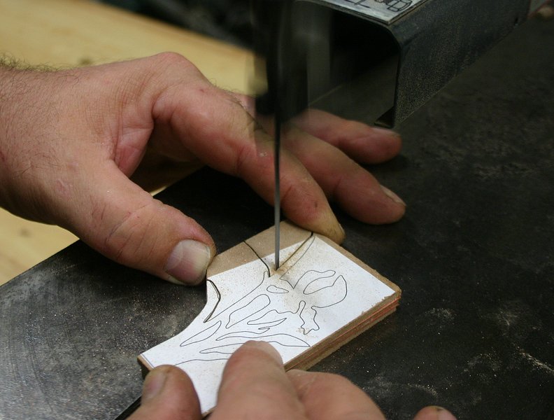

Yesterday, all day, was copper motif day.:o Again, I'm slow as dirt!! Talk about the need for patience and persistence! Being the first time I've used a scroll saw, got to admit that the learning curve was 'interesting'. Breaking blades became a commonplace throughout the day until I got things figured out. Broke a total of 10 blades due to everything from too much tension, not enough tension, too sharp a turn, plowing into the workpiece to quickly…….you name it. Was finally successful however which is all that counts (other than getting it done safely of course).
The plans called for a 20 tooth per inch (tpi) No. 2 blade. The Ryobi assortment package I had didn’t specify the blade No.’s. The blades I started using were ‘skip tooth’ 18.5 tpi blades, .070” wide by .010” thick. They did fair on tight turns but in general, it seemed like a fragile blade. And there were a LOT of tight turns. Here’s the motif pattern on a sandwich of 3 pieces of 1/8” hardboard and 2 pieces of .025” copper bonded together with spray adhesive.
[ATTACH]8889[/ATTACH]
This shot shows you the relative scale I was working with for the smallest motif. Talk about some tight turns. Busted 7 blades before completing this one piece!!!
[ATTACH]8890[/ATTACH]

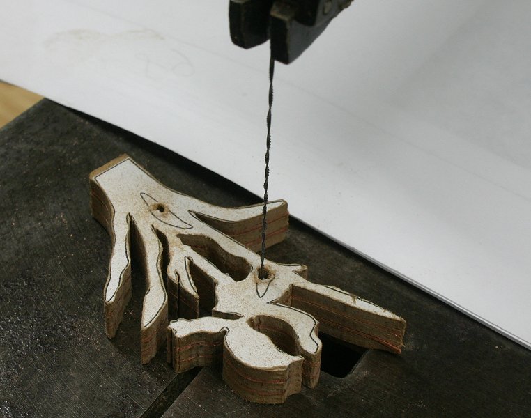

Decided to take a trip to Home Depot (due to necessity) to see what other blades I could find. Picked up a pack of 20 tpi regular teeth that were more substantial. They still didn’t specify the No. but they measured .110” wide by .018” thick. I knew I wouldn’t stand a chance on the tight turns with this blade so I also picked up a package of No. 2 spiral tooth blades, 41 tpi. These blades specified zero radius and all directional cutting. I’d hog out the easy cuts with the 20 tpi beefy blades (first pic) then then do the detail work with the spiral blade (notice the blade geometry in the second pic)
[ATTACH]8891[/ATTACH]
[ATTACH]8892[/ATTACH][/font]
The spiral blades were a bit on the fragile side also, being only .035” thick, but did a great job at getting into all the tight spots. I ended out breaking a few when trying to cut in a side to side or back to front motion. Don't really knowing why they broke. Because of this, I stuck with primarily cutting front to back, rotating the workpiece as needed, and only making minor movements in other directions.

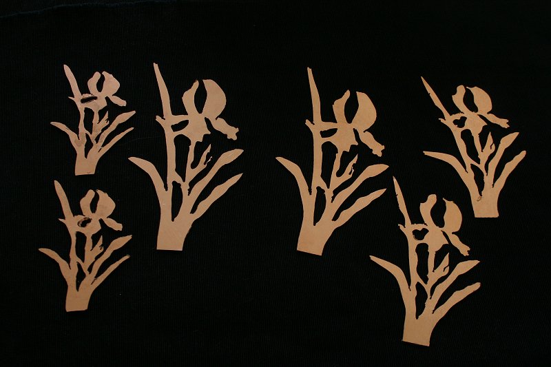

Here’s the end result prior to sanding to remove the edge burrs. That’s today’s task along with taking a propane torch to them to get the pinkish rustic look.
[ATTACH]8893[/ATTACH]
Soooooooo, all that left to call this project complete is sanding the motifs, torching them, and epoxying them to the glass. I've got two coats of tung oil on the lanterns already so today will be the day!!!!:D Photos later this evening!!
