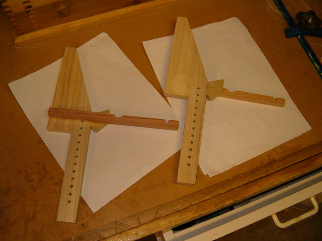

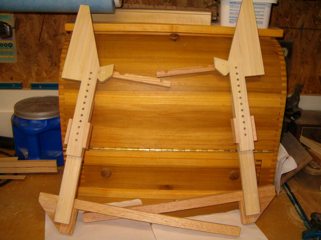

THE DANCER SUPPORTS
[ATTACH]8910[/ATTACH]
THE SUPPORT WITH HOLDERS (used scrap material
[ATTACH]8912[/ATTACH]

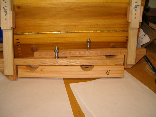

SHOWING ATTACHMENT BLOCKS FOR SHOPSMITH these are from ripped 2X6s
[ATTACH]8913[/ATTACH]

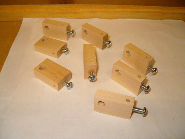

DANCER BLOCKS Hard maple 1"x1/2"x1/4" - 1/8" holes and 1/4" single hole - screw hole tapped, then "crazy glued" then re-tapped
[ATTACH]8914[/ATTACH]

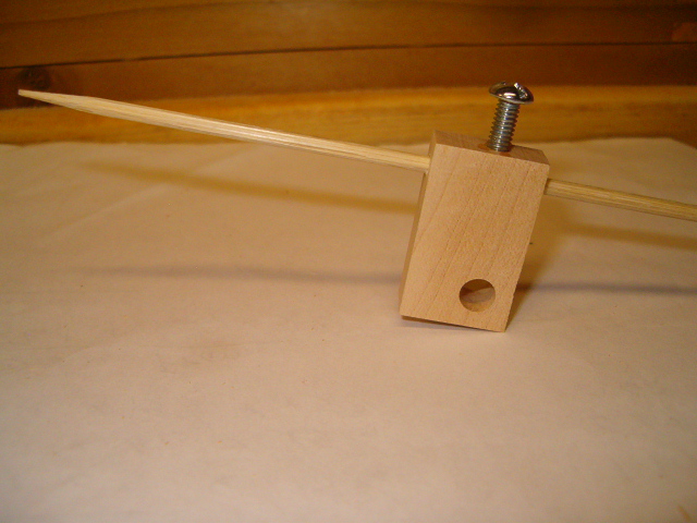

SINGLE BLOCK WITH DANCER dancer is a bamboo skewer - plastic Pick-Up-Sticks would also work
[ATTACH]8915[/ATTACH]

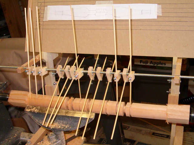

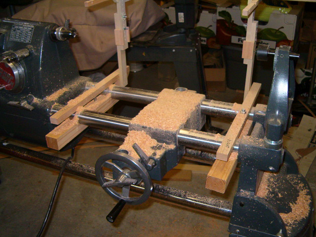

MOUNTS SET UP ON LATHE (photo taken after turning so shows all the chips)
[ATTACH]8916[/ATTACH]

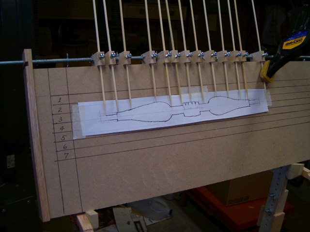

TEMPLATE MOUNTED ON STORY BOARD WITH DANCERS SET TO SIZE
[ATTACH]8917[/ATTACH]

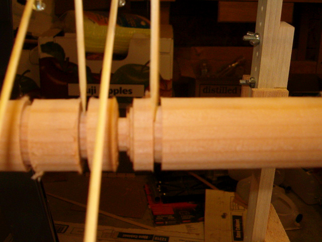

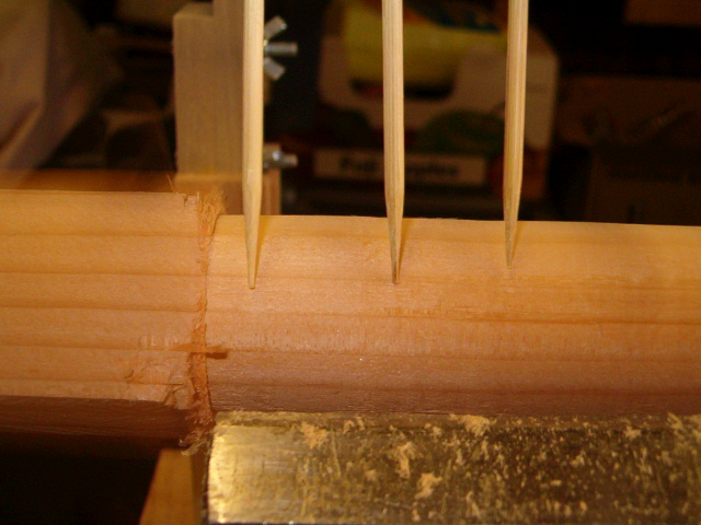

NEXT THREE PICS SHOWING DANCERS IN USE (the lathe was turning when these pics were snapped When diameter is reached, the dancer quits dancing and bows deeply. This is why some of the dancers seem upside down
[ATTACH]8918[/ATTACH]
CLOSEUP OF THE THREE LEFT DANCERS
[ATTACH]8919[/ATTACH]
[ATTACH]8920[/ATTACH]

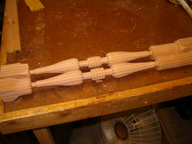

THE DANCER JIG WORKED!!! NOW????? WHERE DO I NEED SPINDLES?
[ATTACH]8921[/ATTACH]
