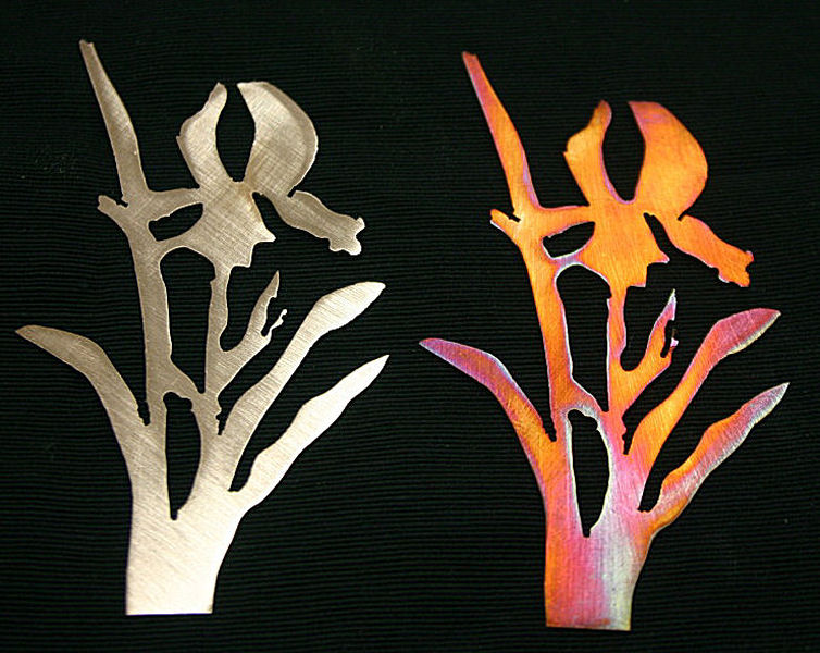

The propane torching was real interesting. The torch was set very low as the instructions called out and you then heat the copper to get the color shift. It only takes about 5-8 seconds of passing the torch back and forth about 3 inches over the copper before the color shift starts to happen then it VERY QUICKLY goes to orange and then pink highlights start to appear. After that, any additional heat takes the color away completely leaving a silver appearance and once gone, YOU CAN NOT GET THE COLOR BACK. Even though I practiced on a single scrap piece of copper, should have tried several scrap pieces to really get the hang of it. Here’s what the motifs looks like in its original sanded state and after introducing the heat.
[ATTACH]8930[/ATTACH]
Where you see lack of color is an indication that the heat was applied a second too long. That’s right….a second.

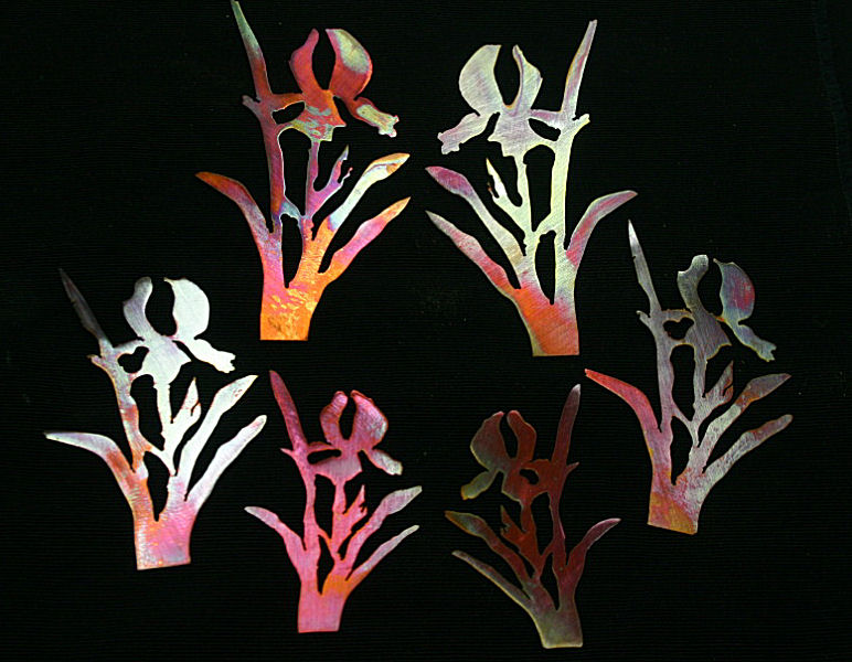

Here are all 6 motifs, best side facing up, followed by the back side. Good thing you get 2 chances to get them right. The back sides show the problem with the excess heat taking the color away.
Good Side

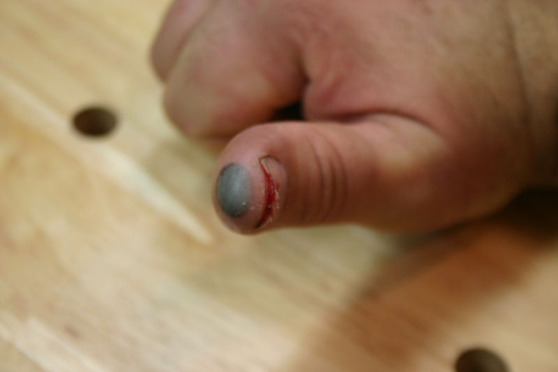

Oh, I guess I have to share my only injury with the group also....don't open it if your squeamish. Darn lucky I didn't get my nail folded back. Glad my nails got softer as I got older. This was from my conical disk sander when I was on the return stoke with my miter gage. For some crazy reason, my thumb decided to extend out and I got popped by the sandpaper and it threw my thumb back toward me. No scratches from the paper somehow but a pretty impressive blood blister and a sore knuckle joint!! I think my problem was I have a tendency to hold everything with a death grip and when the pressure was released, my thumb relaxed....as it was passing the disk!! You should have seen me holding those motifs when I was scroll sawing. My forearms are STILL sore. Gotta loosen up a tad.:D
