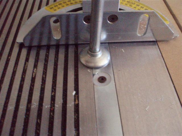

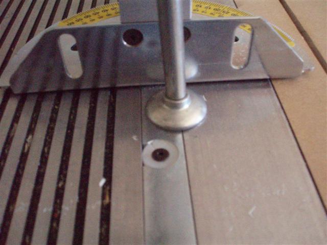

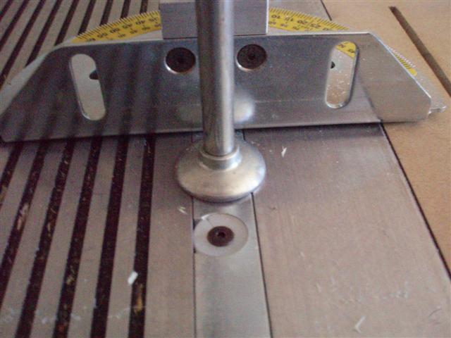

I'll try to post some pictures later to show how much mine moves.
Anyone whose grip is not so inclined to allow lateral movement might help by posting some pictures also.

[ATTACH]9171[/ATTACH]
[ATTACH]9172[/ATTACH]
[ATTACH]9173[/ATTACH]
What you see here is the best it gets. If I move the hold down pawl away from the fence the movement is a bit more than shown here.

dusty wrote:I don't believe that the side to side movement that you have described is excessive. It would be if that movement occurred with clamping pressure applied but you said "but not put under pressure with the hand grip".
However, I do not rely on the Safety Grip for those situations that might result in this sort of movement. In others words, I use it mostly on the saw table for cross cutting.
I have two, one moves 0.25" and the sloppier one 0.50". That is with it tightened, but not 'squeezed'. The amount of motion with it not tightened is not going to affect its ability to hold when tightened, then squeezed.
The difference between the two is that the 'sloppy' one has more clearance in the pistol grip socket thus allowing more rotation of the 'mount'.
EDIT: Removed ±].
