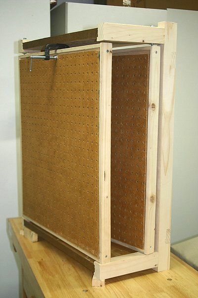

Until one feels the pain a few times, the need to not measure just doesn't register, especially for one who's entire career had been in Quality Assurance, dealing constantly with measurement systems. Virtually nothing in my line of business is relative...it all has dimensions and associated tolerances.
Tonight, I made the pegboard panels for the doors without taking a single measurement. Alleluia!!! It was all based on the fit of the pegboard into the rabbet recess on the door frames. Just laid the sheet of pegboard stock on the workbench, traced the outline of the doors interior edge onto the sheet and went in a little less than the 1" rabbet and bada bing, cut it there. Worked great (AND felt good doing it too). Yesterday, I would have measured and cut. I have to admit that since the pegboards hole to hole spacing is 1", that visual clue was great for helping me make sure the pegboard panel was square since at this point, the door frame ISN'T. The square panel will now be used to square off the door frame.
Goal for tonight was to have phase III completed which was all cutting done, the assembly dry fitted, and everything ready for sanding and sealing tomorrow. Goal accomplished.
[ATTACH]9291[/ATTACH]
[ATTACH]9292[/ATTACH]

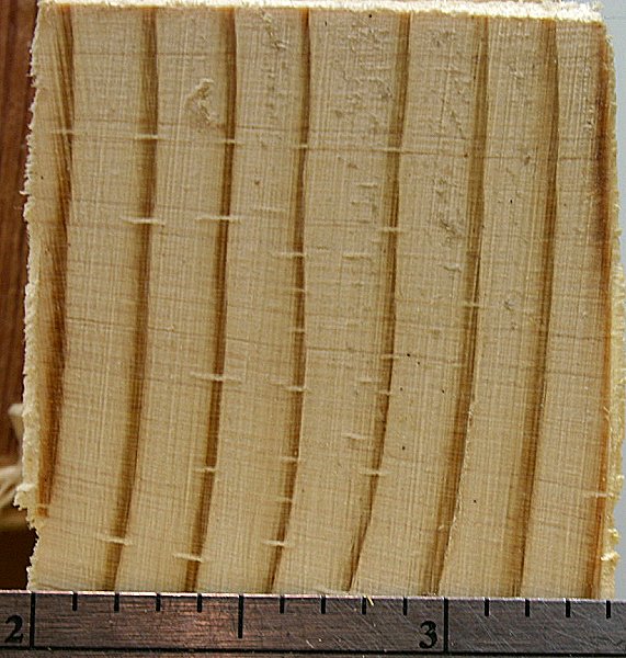

Gotta get this out to not sway opinion.....the gray piece in 389 is a mongrel piece of 2x4 I had. I botched up on both of my initial uprights and had to remake them. Since I had that wood already, it saved me a trip to the store. It is NOT the same as the rest of the stock. Chuck reference to post 369 is worth showing since it shows the grain better.
I read Chuck's excellent post on wood determination method and am going to give it a try. I had read about that method somewhere previously when I was trying to determine the type of wood that my ER bench boards were made of but never bothered to try it.
I now see reddish hue in the wood when I sanded the end grain on the uprights tonight.

If it be Douglas Fir, it be sap, not heartwood! I agree with chuck, the grain is a bit too pronounced for spruce. I noticed that earlier, but dismissed it as a lighting phenomenon.

Also, here's a look at the sanded (80 grit) end grain of my wood. Scale is in 10th's of an inch.
[ATTACH]9294[/ATTACH]

This whole species thing is getting interesting. The technical stuff made my brain hurt. I will stick with my original thought that it is not D fir, but in the light of the other learned opinions here I am prepared to be shown the error of my ways. I have always in the past been in the presence of any wood that I was trying to identify and for one with which I am as familiar as I am with D fir there would be no question. The appearance of the grain, the frequent presence of pitch pockets, THE SMELL, the feel with a chisel or knife, the weight and many other factors would make it obviously D fir (also sometimes called Oregon Pine I believe). All I can say is it sure doesn't look like any D fir I've ever used.
