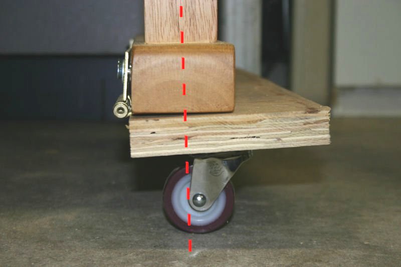

I almost forgot to show a change I made on my workbench casters. The previous design with the hook and eye screw wasn't effective. That was done to prevent the wheels from folding under when the bench was moved. The design was inferior because the plywood was too narrow and the casters axle was not outside the vertical leg centerline. I added a wider piece of plywood to move the caster outward.
[ATTACH]9503[/ATTACH] .
The plywood is now a bit too wide. I'll cut if off at the end of the casters mounting plate so that I don't have to lift the bench so high when I want to move the casters from their raised to lowered position.

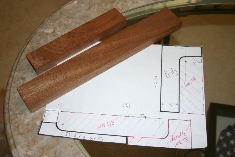

I wanted to use the left over African Mahogany from the candle lantern project. I only had 2 pieces left over that were the specified 3/4" thickness. Based on the magazine articles cut out plans, I drew up scaled paper templates of the two parts. Obviously didn't have enough wood to use that method.
[ATTACH]9507[/ATTACH]
The cutout plan for the smaller sliding arm, shown on the bottom of the paper in the photo above and also in the photo below, has material for handles used while doing the 1/4" edge roundovers. That excess material is later cut off. I won't have enough material to do it that way so I'll need a plan B.
[ATTACH]9509[/ATTACH]

So this is roughly the way I'll layout my cuts. I'll figure out a way to add the temporary handles in order to keep the pinkies safe during the routing operation. Probably will just screw on some sacrificial pieces.
[ATTACH]9506[/ATTACH]
