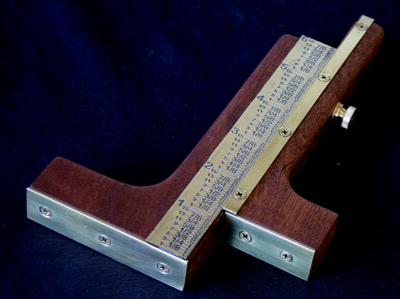

Finished Adjustable Setup Gage with Brass Scale
Here's the finished setup gage, including the custom made brass scale. (thanks again for that idea shipwright!!)
[ATTACH]10202[/ATTACH]
The 'brass darkening solution' from Rockler worked great on enhancing the etched lines. First tried brushing it on just the etched portions but it just puddled. It doesn't have good wetting properties. I then poured the 2 oz bottle in a ziplock bag and stuck the entire scale in it submerging it completely. After about 5 minutes, I removed the scale and it was completely black, similar to what's left over after you do electrolysis on steel. Rinsed in tap water and baking soda mix to stop the action and wiped it down with a paper towel. After that, rubbed off the black with 00 steel wool making sure to not press down too hard so that it left it down in the etched areas. The photo makes the etched areas look a blue gray but it actually appears a dark gray to the eyes. Very satisfied with the process.
The scale has to be able to move vertically in order to do a depth measurement so it's adhered to steel scale with double sided tape and there are 2 rare earth magnets epoxied into the wood that hold it in place.
