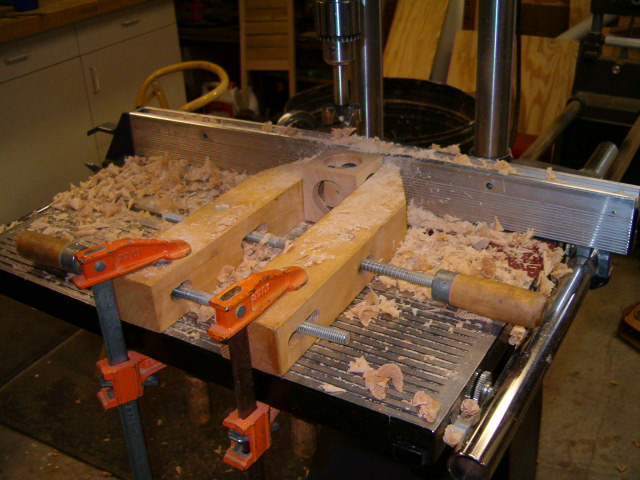

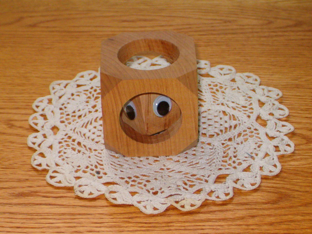

Handscrew use is how to make a box-in-a-box. This one I called an eye-pod.
[ATTACH]9491[/ATTACH]
[ATTACH]9492[/ATTACH]
[ATTACH]9493[/ATTACH]
