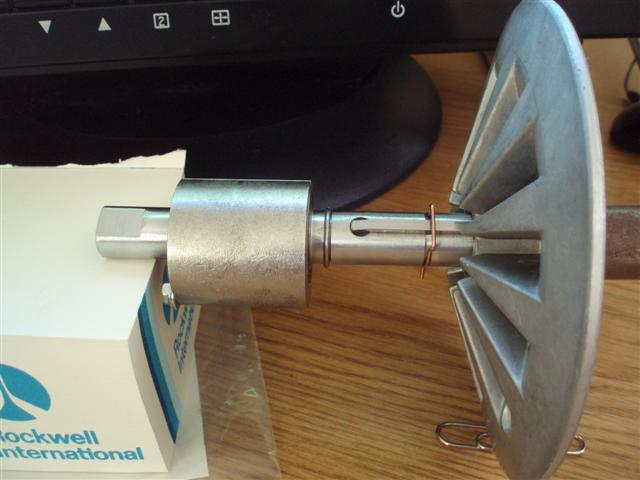

HOW long is the short keystock for the Idler Shaft?
Who ever rebuilt this puppy in the past left the key stock out of the shaft with the variable pitch upper pulleys. The Exploded View of the Parts Manual shows it to be the short key, but how long should it be? I got a 12" long piece of key stock, so I am ready to cut it and fit it. Thanks ahead of time for the help. You Folks are GREAT!!
The keyway also has a crook in the end that retains it in the 'groove'. There is a slight deeper cut in the 'groove' under the 'fixed' half of the pulley. It is probably best to get this part from ss, unless, you are adept at both 'forming' the keystock, and guessing what those bends should be.mgdesigns wrote:HOW long is the short keystock for the Idler Shaft?
The crook nests into the deeper part of the 'groove' and the fixed pulley half slides over it and keeps it in place. The fixed pulley also has a retaining spring/clip that prevents it moving along the shaft. It fits into a narrow groove in the shaft.

A picture is worth a thousand words. This is the idler shaft assembly minus the idler sheave.JPG40504 wrote:The keyway also has a crook in the end that retains it in the 'groove'. There is a slight deeper cut in the 'groove' under the 'fixed' half of the pulley. It is probably best to get this part from ss, unless, you are adept at both 'forming' the keystock, and guessing what those bends should be.
[ATTACH]10372[/ATTACH]
- Assembled (Small).JPG (41.86 KiB) Viewed 2961 times
