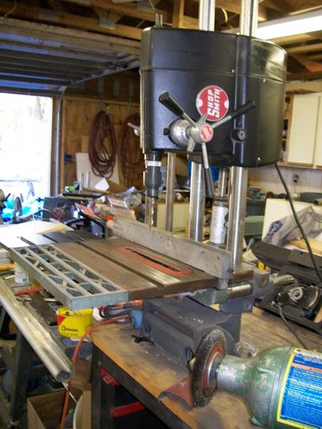

This is my dedicated drill press/milling machine. It has a Master Shop cast iron/steel (its heavy) carriage, main table and extension with a small jack for raising the headstock. I have a short piece of "L" bolted to the carriage the the jack sets on. The jack is also bolted to the "L".
[ATTACH]10445[/ATTACH]

Ah, yes, I remember now. Your setup seems to me to be about the best configuration. I like the carriage sitting on solid ground (so to speak) with the only real movable element being the jack-raised (lowered) headstock.
Solid.
I'll add a couply (fixed) blocks under the table directly below the quill, for even more support of the workpiece.

In case you did not notice, I forgot to say that the headstock, carriage and main table0areis mounted backwards on the way tubes so it over the base and base arm so it takes less room (footprint) on the cabinet. Yes, I have a couple 2X4 blocks under the table when using it as a milling machine. I use a X/Y vise for this task.
