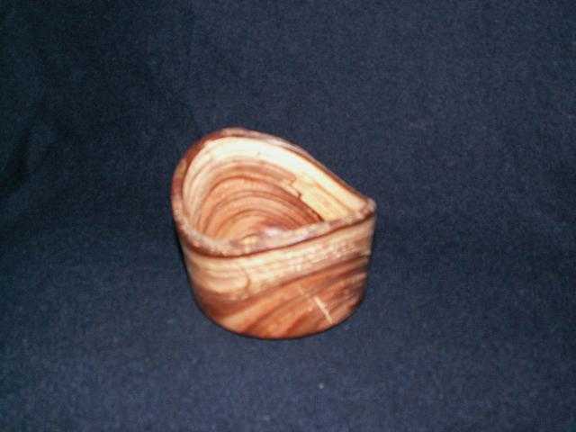

Thanks again for all your help. I have been in touch with several of the guys from the AAW chapter in Kennewick 80 miles from me. They have been as helpful as all of you. I am going to their next meeting in November and they have several members here in Yakima! Woodworkers sure are a class act. I am not giving up. I am attaching a picture of a little bowl I just finished this afternoon from a piece of Acacia Koa I sent back from Maui in September. Obviously this was not from the piece that was causing me such grief. Thanks again for all the help and encouragement.

Very NICE looking piece ya turned.

Good on Ya for not giving up and I'll add my compliments to Beeg's. Good job! There'll be no stopping you now.
