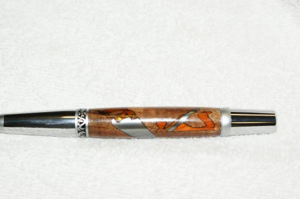

Just a word of caution. I have recently turned some of the nlaid pen kits and found tht the CA glue seems to grab a lot quicker whenCA glue comes in contact with previously applied CA glue. The inlaid kits uses CA thin glue for the puzzle pieces which migrates to the inside of the blank and when the tube is inserted into the blank with more glue the blank grabs prematurely. So if you move slowly I would recommend two part epoxy with an open time of at least 5 minutes. The inlaid kits sure do make a nice pen but are pricey.
[ATTACH]10727[/ATTACH]
Bill V
Bill V
- woodworkers pen 1.jpg (70.74 KiB) Viewed 1982 times
