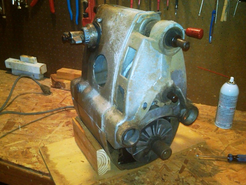

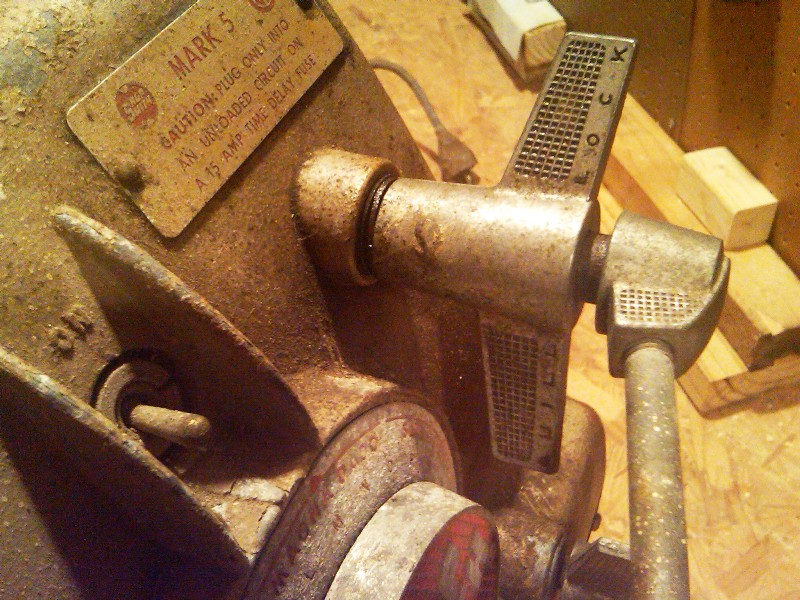

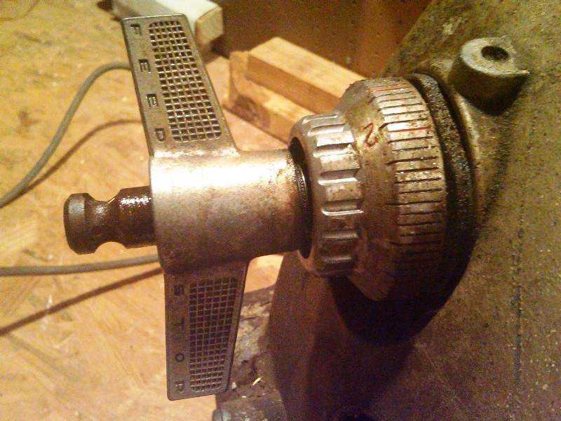

Opened the Headstock
First, let me say, "THANKS" to all you military vets. We just wouldn't be us without you.
Secondly, this is probably going to be old hat for a lot of you SS veterans but I have to share it with somebody.
I finally decided to crack open the headstock last night just to see what I'm dealing with. To my surprise, this thing is really a lot simpler in person than in the manuals and videos.
First I built a headstock cradle out of an old cabinet door, some scrap 2x4s and 3" deck screws. I found the 2x4s need to be no longer than about 8 inches and spaced about 7" apart, with a high taper cut in the top 1 1/2".
I have not powered up the unit so I slowly rotated the speedial to fast while rotating the drive shaft by hand. The drive belt was fairly loose on the sheaves anyway and the pork chop didn't seem to have too much friction between it and the idler shaft. I didn't get much resistance from the speed changer.
So far I have found:
- The quill spring is either shot or REALLY grimy because it won't automatically retract the quill.
- The feed depth is slipping and the knob has to be made way too tight for it to work - but it works.
- The pork chop and clip spring are in good shape but like everything else, covered in dust and grime.
- The drive shaft and idler shaft were unrecognizable as separate parts from the housing with all the layers of filth.
- The wiring and switch is in surprisingly good shape. Given the condition of the exterior of this thing, I thought it would be cracked and the switch would be corroded at the contacts.
- The belts also look great for not having run in 30 years but they will be replaced anyway.
- The idler sheave slides on the shaft pretty well.
- While the putty over the setscrew above the quill has been removed, it's still in the screw well over the feed stop. I don't think this machine has been serviced much.
Here are some exterior shots:
[ATTACH]10849[/ATTACH]
[ATTACH]10850[/ATTACH]
[ATTACH]10851[/ATTACH]
[ATTACH]10852[/ATTACH]
[ATTACH]10853[/ATTACH]

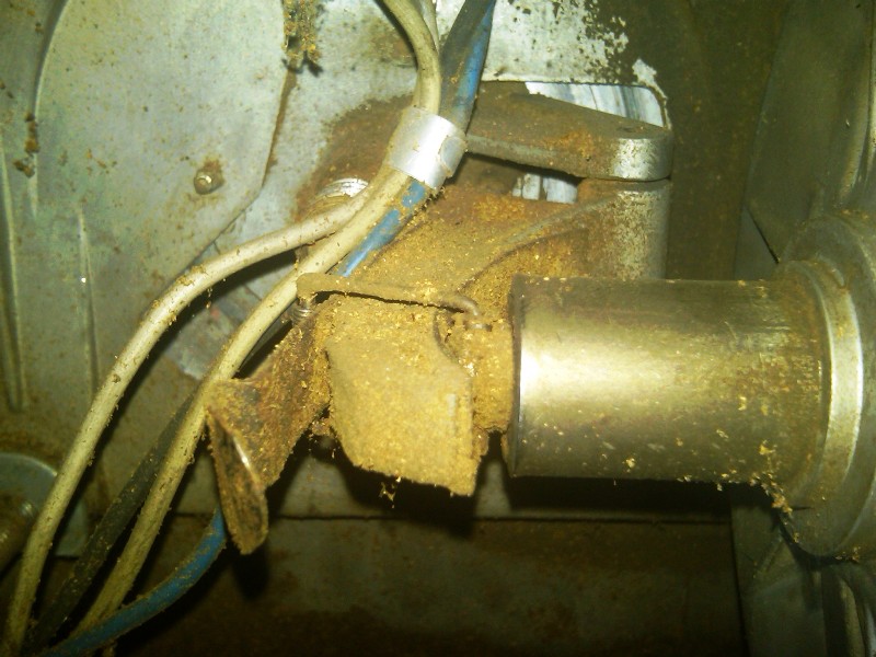

Opened the Headstock Part 2
Here are some more shots, idler shaft and interior:
Before oil and brass brush
[ATTACH]10854[/ATTACH]
After - wow that's a lot of grime
[ATTACH]10855[/ATTACH]
[ATTACH]10856[/ATTACH]
[ATTACH]10857[/ATTACH]
Wires look to be in good shape. Just a lot of sawdust. This shot was taken before I ran the speedchanger up to 'fast.'
[ATTACH]10858[/ATTACH]

Don't make any decisions now until after you have cleaned her up to the point of spotless. Then lubricate everything according to the manual. Wax the outside of the quill housing. Then and not before then is it time to power her up for a maiden run through the speed range (up and then down several times).
When in the process of cleaning, I would drop the motor pan, pull out the motor and clean it. While running the motor on the bench, blow the dust out of the inside of the motor. If you do this, cradle the motor when you turn it on so that it does not jump off the bench. Ground it too.
You'll be amazed at what she is going to look like. These machines are just shy of being a miracle.
I guess I'm going to have to break down and ground my shop circuits.
