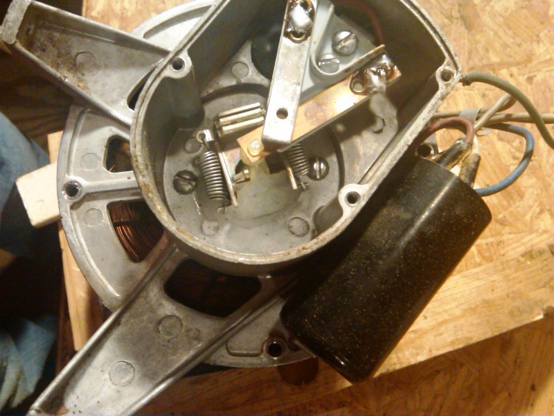

1. Alright, I still can't get the motor apart and now I HAVE to in order to resecure a washer that has slipped down the shaft internally.
I know each end plate should come off I just don't know how. A.O. Smith still makes motors but no longer a 1 1/8. They have some interesting resources like this A/C D/C manual but nothing about this 50-year-old motor.
Here are some shots of the beast. I've removed every screw I can find that I believe would hold it together. Nothing. One end has rivets in it but they are not structural. Can somebody help?
[ATTACH]10938[/ATTACH]
[ATTACH]10939[/ATTACH]
The motor plate data is:

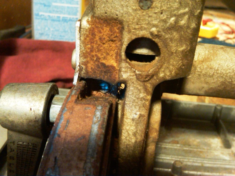

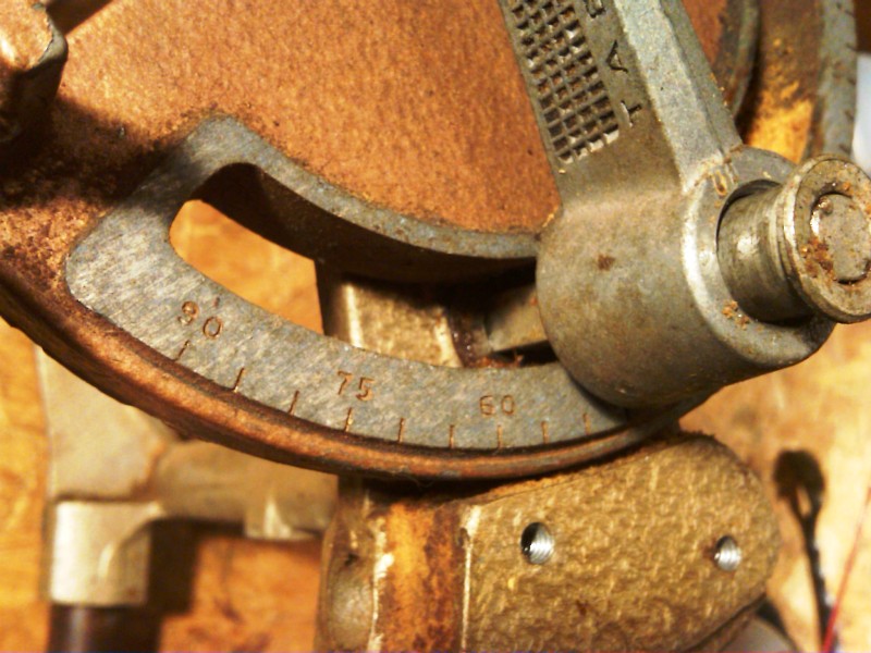

2. I haven't been able to remove the stud in the work table that holds the trunnion to the tie bar. Does it just require a punch to knock it out? I also notice the exploded diagram shows a "tie bar shield" which I do not have. Did the Goldies come with one? I'm betting not.
[ATTACH]10940[/ATTACH]
[ATTACH]10941[/ATTACH]
These photos don't show it but all screws have been removed from the table. The only think holding the trunnion on now is that stud.

re motor......I can only speak of my ER10 motor. I whacked the shaft with a nylon mallet and the back popped off. Bill Mayo shared that secret with me.
re trunnion......if your just trying to remove the trunnion from the stud, you turn the locking nut clockwise to tighten it so that you can file down the deformation made to the stud by the punch. Once it's cleaned up, you can remove the locking nut. Use protected pliers to turn the locking nut.

Yes, those 2 screws holding the end bearing needs to be removed plus the screw holding the centrifugal weight assembly to the end of the shaft. This screw is under the tip that pushes on the contact strip. This can be a very diffficult screw to remove as the weights are always in the way even when the springs are disconnected. I use an old trick for loosening this screw and retightening it. I use a nail center punch and set the point at the outter edge of the screw's flat blade screwdrive slot so when I tap the punch, it will slowly rotate the head of the screw. I have a #2 phillips screw driver reground for a flat blade end that works some times. I use the punch to tighten this screw. It can be very difficult to center the weight assembly on the end of the shaft and tighten this screw at the same time. I normally file the end of the slot on the motor shaft to remove any sharp edges so the weight assembly will fit smoothly and prefit the weight assembly before assembling the motor. You have to make sure the bearing retainer plate in on the motor shaft before installing the end bearing.nuhobby wrote:I'm pretty sure those 2 screws near the copper leaf-contacts are holding a bearing-retainer, so they are effectively holding the "wires end" of the motor onto the shaft. If you remove those screws, then the "wires end" cap of the motor can come off.
I have been replacing the copper leaf contact assembly when wires are soldered with a new assembly with slip-on .250 flat connectors so I can remove the end plate. You have to be careful not to destroy any wire insulation to the contact assembly when moving the end plate to secure the bearing retaining plate with its screws.
I will be happy to respond to any questions and have some pictures available.
RE Chris - Nuhobby
Chris,nuhobby wrote:I'm pretty sure those 2 screws near the copper leaf-contacts are holding a bearing-retainer, so they are effectively holding the "wires end" of the motor onto the shaft. If you remove those screws, then the "wires end" cap of the motor can come off.
You are correct. That's the "washer" I was referring to that has fallen down the shaft. I have been able to pop the unpainted "wires end" cap out of the housing but it only moves about 1/4" and then stops. The cap moves free of the housing but the shaft/bearing connection doesn't pop loose very easily and I'm afraid to pry too hard. I'm not entirely sure what's keeping it.
As for the "fan sheave" end, the unpainted end cap won't twist or otherwise pop out of the housing. At least, I haven't applied enough force for it to come off. Should I just twist the end caps until they pull out? From a the exploded diagrams I've found online, it looks like the shaft, bearings and end caps assembly are just pressed together. Am I reading the tea leaves correctly?
Maybe I just haven't applied enough elbow grease but in several instances on this project I've found I had something else to loosen first. I snapped off a chip from the table tie bar casting (it was already cracked, though) from this method too so I'm a little gun shy.
