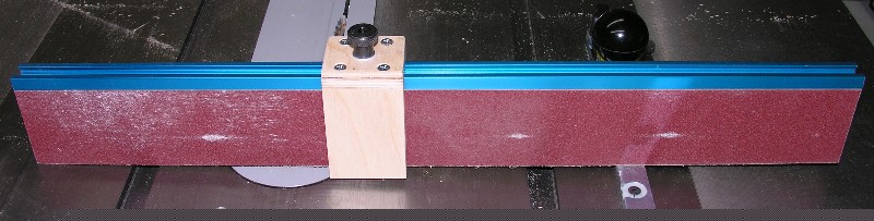

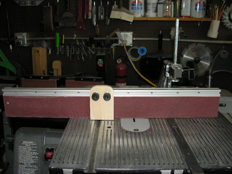

I make my own out of 3/4 Baltic birch ply, sandpaper and t-track. Easy to do and you control length and you can move them to best position on the miter gage.

[ATTACH]11089[/ATTACH]
[ATTACH]11090[/ATTACH]
[ATTACH]11091[/ATTACH]
ldh
- MiterFence1.JPG (102.42 KiB) Viewed 4085 times
- MiterFence3.JPG (127.8 KiB) Viewed 4087 times
- IncraV120Fence2.jpg (58.48 KiB) Viewed 4085 times
