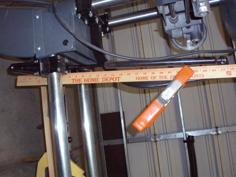

Measurements in blue.JPG40504 wrote:Dimensions needed(from an existing Mark 5/V) lift assist needed are:
1) Hinge pin(pivot) to bottom end of gas tube attachment point(on the bracket attached to the bench tubes). Does not vary when raised to vertical. Approx. 9 1/2"
2) Hinge pin(pivot) to other end of gas tube attachment point(on the arm attached to the way tubes. Does not vary when raised to vertical. Approx. 18"
Those distances are fixed regardless of what rotational position the headstock and way tubes are in, but the separation of the attachment points increases as it is raised to vertical. As you have provided, that increase cannot be more than something less than 17".
Perhaps one reason we be on, different pages, is that I perceive(wishful thinking?) the same hardware on the same end functioning as an assist(albeit through differing motion) for lifting using a pivot(Mark 7) on the opposite end of the tubes.
I had noticed the apparent positioning of the gas tube external to the bench tubes in the distant past and have always been concerned that what I thought should be between the bench tubes was somehow actually outside of them. Me thinks a bit of photo shop wizardry gone awry?
Input received! Thank You!! Stay tuned(may be a while though).dusty wrote:Measurements in blue.

I'm still not sure I know what you are seeking. Hopefully this will help.JPG40504 wrote:As a 'double check' to my 'plotting', what is the gas tube attachment points separation when horizontal and vertical (~ 18"(down), ~18"+extension(up)) TNX
I am assuming the bench tube gas tube attachment point is 2-3" out from the pivot.
OK I made an incorrect 'assumption'. The dimension between the attachment of the gas tube on the arm and the pivot will change between up and down position.
What is the pivot to gas tube attachment point on the arm dimension when raised to vertical? SAT!!!
[ATTACH]11217[/ATTACH]
- Lift Assist 002.jpg (232.66 KiB) Viewed 5706 times
